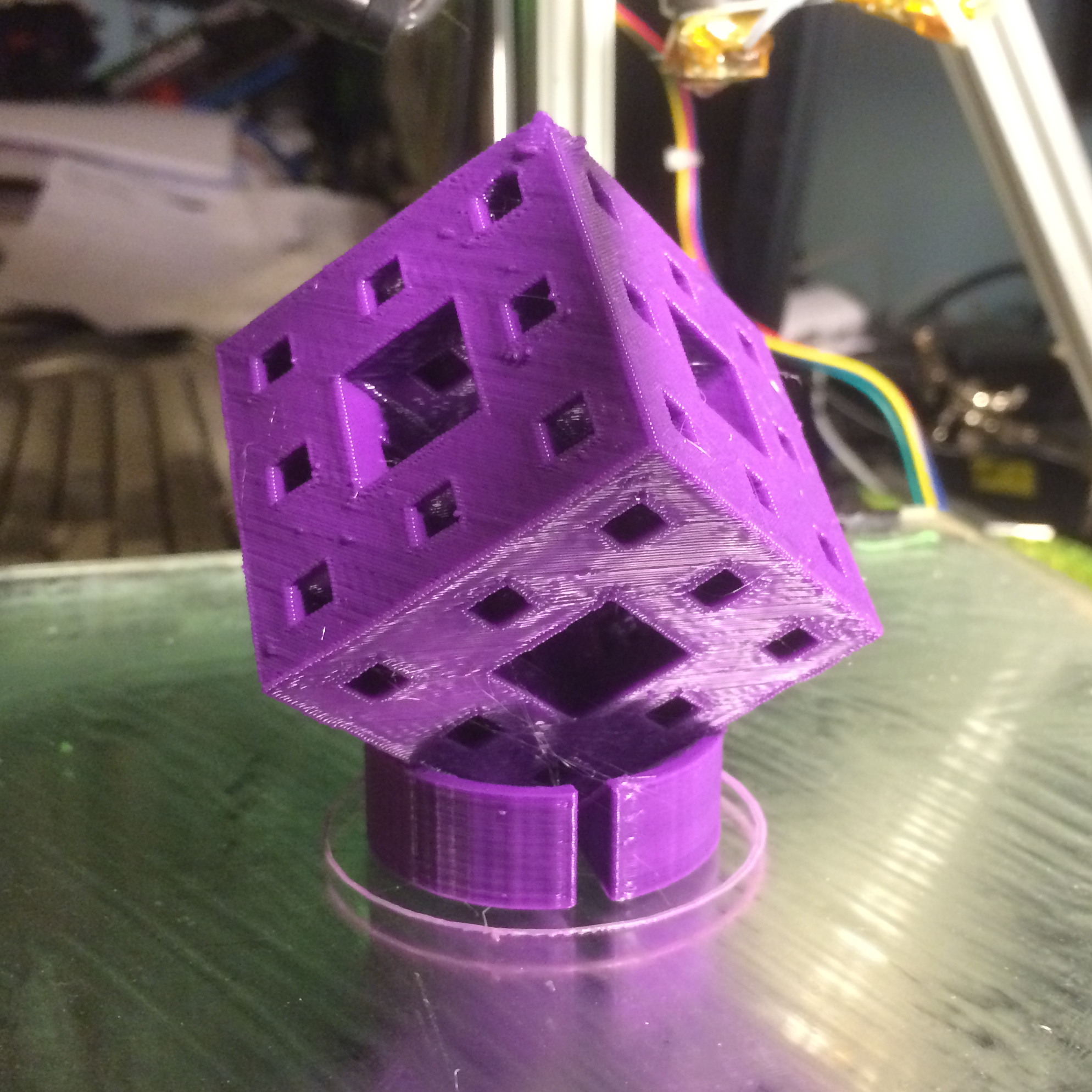

Continuing the Menger sponge development, a way to print one without unremovable support material in all the holes or having to glue two halves together: http://www.thingiverse.com/thing:238551
What is your layer height set to
@Ethan_Hall
For this print, 0.3 mm, but I need to try it again at a lower height. I think I’m also printing this plastic a little bit too hot, the surface finish isn’t great.
