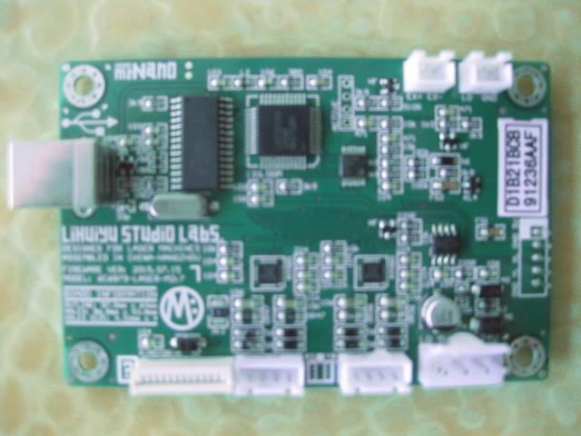

Controller model is 6c6879 laser m2:7 I think I need a new board or a replacement. Where can I find one? I appreciate your advice. John von
Ebay usually has some, but now might be a good time to upgrade it to a smoothieboard and use LaserWeb. All depends on your skill level, but the upgrade is fairly easy, quite a few of us have done it, so help is available.
