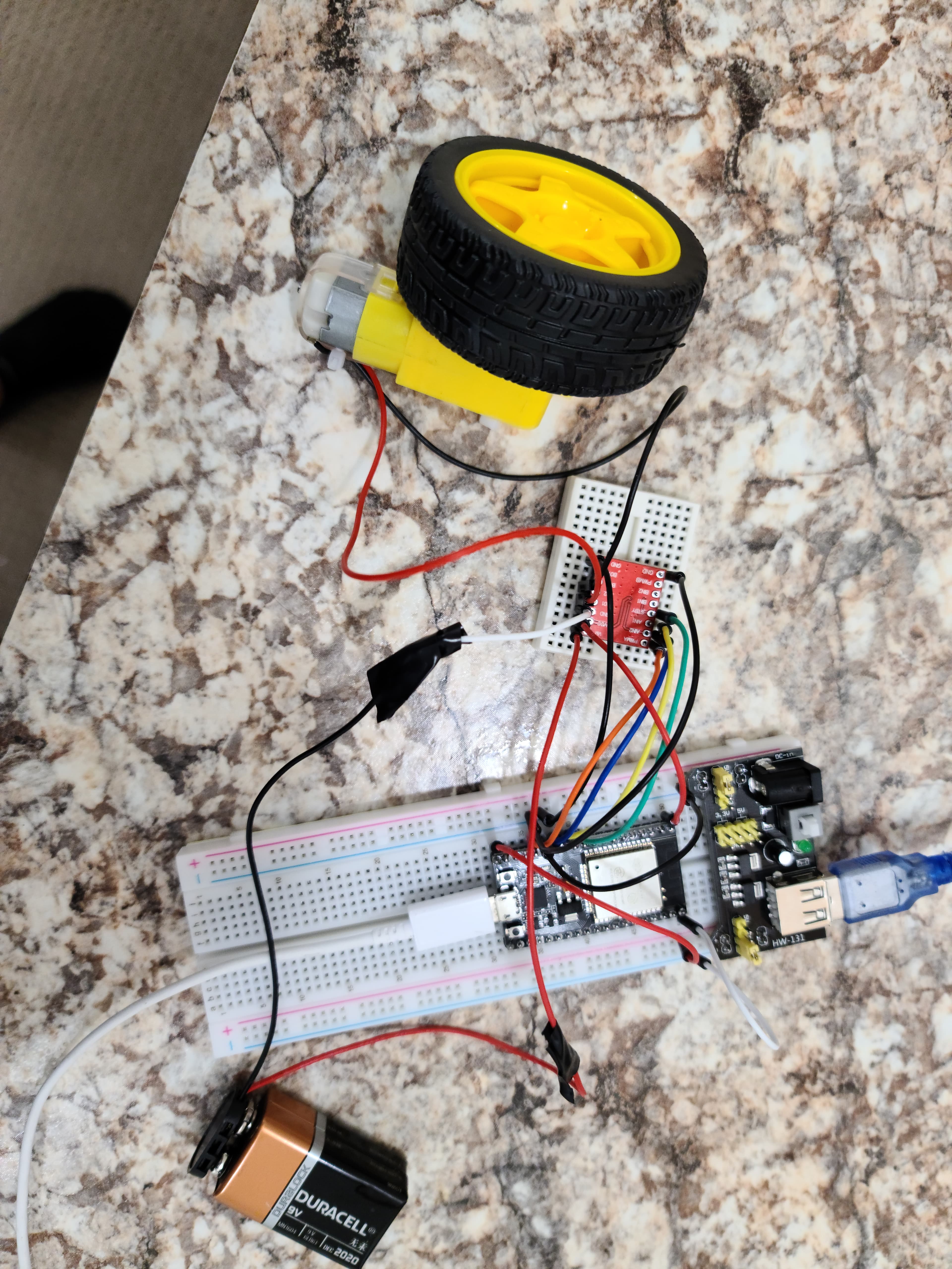

Hi Don, thanks for replying. Happy Friday! Sorry for taking so long. I looked for a good breadboard layout solution and found that Tinkercad has one, so I whipped up a wiring diagram.
Firstly, to answer your questions:
  1. Are you using a motor driver board or directly wiring to the TB6612?
The TB6612 is the motor driver board and I’m wiring up the ESP32 directly to it.
  1. A picture of your setup may help.
The four sets of 8-pin headers represent the 32-pin ESP32. The two lower sets represent the TB6612FNG board. I couldn’t figure out how to overlay the pics in Tinkercad so left it as-is.

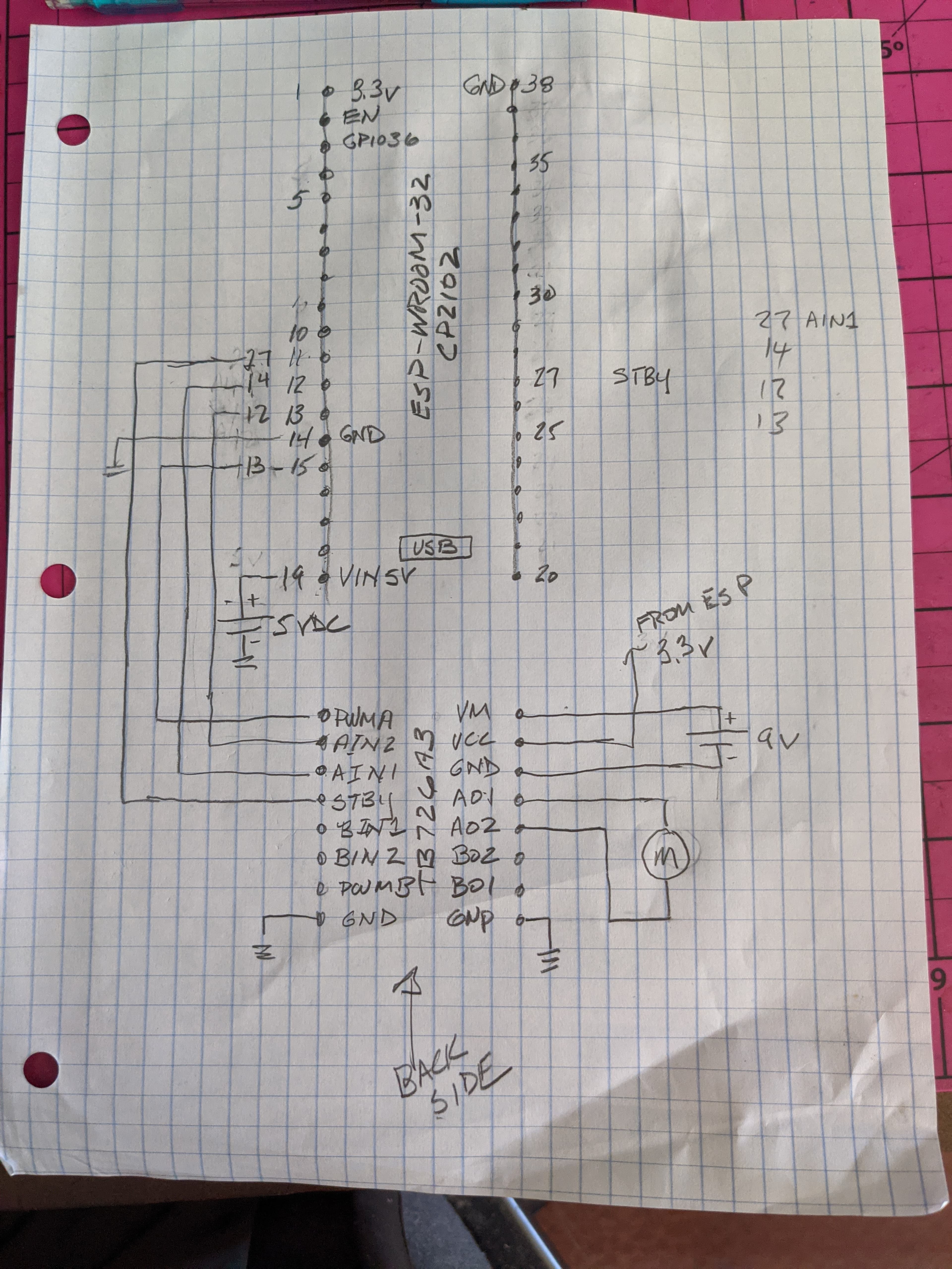

I took a look and drew up a schematic of what I interpret your setup to be.
Let me know if I got it right.
I found nothing obvious…
I would try these things:
  • Disconnect Standby from the motor controller. I think that will enable it. See if that allows the motors to turn on. In any case leave it off for now.

Hi Don, thanks for the reply and for your time on this. When I get some time over this weekend I’ll try out your suggestions. I had heard from somewhere that STBY needed to be HIGH in order for it to work, and the code I use asks for the STBY pin in the class constructor. But it won’t hurt to try disconnecting it.
I also saw someone in a different forum talk about it working after they soldered the header pins, which I haven’t done yet. I just placed the headers in the breadboard and placed the TB6612 on top without soldering. Maybe soldering will do the trick. :smiley:
Your schematic is exactly how I have it; I’m glad to see my diagram was readable. lol
