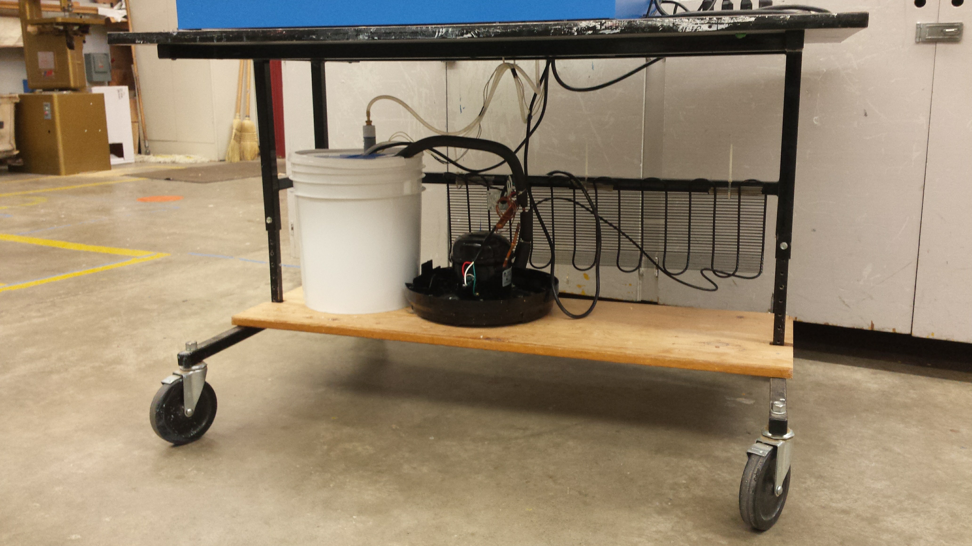

Cooling question. I got an old bottled water cooler and modified it to use with my K40. I have 2 questions.
One, can I oriented my evaporator coils horizontally like shown in the picture or do they need to be vertical?
Second, is it going to hurt anything to have the condensing coils in the water or do I need to set up some type of exchange system where I circulate my water through a bucket of cold water? I am worried about changing the conductivity of the water by having copper coils in the cooling water.
One. I believe since it’s a closed loop system, horizontal or vertical orientation does not matter.
Second. I do not know the answer.
@donkjr may know the answer to the conductivity question.
I think Cesar is right that it most likely makes no difference on the refrig. coils.
My opinion about the copper coils is that they will most likely leach out into the coolant water and would cause conductivity issues. It would be interesting to know if Don has any studies with copper immersion over time.
I’m struggling with that issue also and how I’m going to use my Peltier system as the cooling blocks are aluminum which I believe can cause the same problem.
I was considering stainless coils …pricey… but if they are passivated correctly then that could prevent that problem. However (Sorry I have to go here) assembly operations that could scratch the surface can cause problems so I’m not sure how I would handle this.
I mostly settled on just running the coolant through the Peltier system and I’m looking at epoxy coatings (Maybe 1838 made from 3M) by diluting it in acetone and flushing through the aluminum cooling blocks then force air drying .
That may be an answer for your copper coils as well… coating them with an epoxy.
Unfortunately, 1838 epoxy is pricey 50 plus bucks for a 2 oz kit plus shipping so I’m looking for an alternative.
Chlorine or low pH will accelerate copper oxidation/dissolution. Just pure water will also cause copper to leach due to dissolved oxygen or absorption of CO2 which can lower the pH. Not sure of the rate off hand, but it could cause significant conductivity increases overtime. I’ll try and dig into it a little more later.
Right now I have straight distilled water. I hadn’t thought about epoxy coating the coils. right now they are connected to the stainless cylinder that held the cold water. I think I will try the epoxy and see how it goes.
What are the signs of conductive water? Squealing power supply?

I know it has been mentioned before but what is the ideal temp?
@Steve_Clark
I have not done any tests on the effect of copper on water conductivity. We would need to calculate the area exposed to the water considering the flow rates etc. Could be complicated to get right.
It might be easier to just do it and measure the conductivity regularly, which I reccomend anyway.
@Nedman I don’t know what the rate of oxidization would be especially considering water flow. I would imagine that the time it takes for the water to become conductive from copper oxidation would be longer than the time between maintenance exchanges anyway… but that is a WAG.
@Martin_Dillon I’ve spent some time reading up on and talking to manufactures recently and there seems to be some minor conflict between them as to the idea temperatures of operation.
For the most part they all agree it’s generally acceptable for the tubes to be kept within 20℃ - 31℃.
However, your relative humidity controls what the ideal temperature is and those zones could be even lower if one was able to control the moisture content by keeping it’s dew point below your operating temperature.
The main concern is avoidance of internal mirror condensation and this write up below has a helpful chart (Table 1).
http://www.synrad.com/Manuals/Technical%20Bulletins/TB12_Prevent%20Condensation.pdf
@Steve_Clark thanks for the pdf. Lots of good info. From all the feedback, I think I am going to ditch the cooling and go to a bigger reservoir. I definitely need to invest in a good thermometer.
I personally would keep your cooling system but you will need to add a thermostat, probe, and relay to turn it on and off as it’s needed to keep you water cool.
Or just add a temperature probe/readout and a switch to turn it on and off by hand as needed. Got to be careful this way though…a switch with a built in timer might be safer.
I’m using these below as I don’t want to spend the time building a controller.
http://www.lightobject.com/40A-Solid-State-Relay-SSR-DC-In-DC-Out-P315.aspx
http://www.lightobject.com/10ft-3M-K-Type-Thermocouple-P114.aspx
You will need to buy or make a heatsink for the relay if you go this route.
