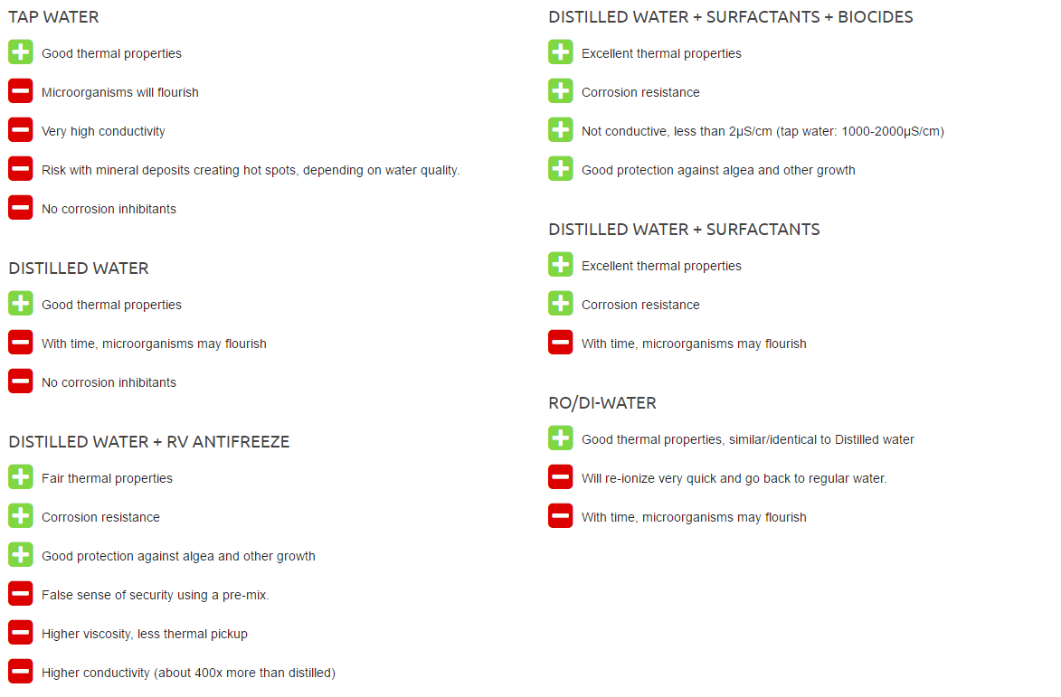

I wrote a article about coolants a while back, i´ll add the infographics i made below, maybe can give some ideas to someone.
This is after testing alot of different coolants and their properties (conductivity, viscosity, thermal properties and bio-growth)
The corrosion part isnt a big issue for us though, but it may affect the anode and/or metal parts in the pump/loop.
