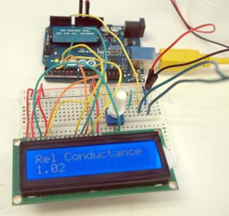

This looks interesting, i’m building my closed loop system at the moment and have an arduino controlled safety system monitoring flowrate and temps. I know this probe isn’t accurate like a proper meter but i should be able to calibrate it to only enable my laser when the voltage is within acceptable levels.
I imagine this code will only run once as part of the boot, i’ll have a DPDT relay trigger once its ran to remove any connectivity from the probe tips to anything electrical.
@John_Sturgess I have built a similar one, it´s pretty accurate to a “real” meter, enough for our usage atleast :slight_smile:
I did the same thing, added the code to the arduino that already controls the security, water leaks, mirrors temps and stuff on my machine. It gives a hint anyway when the water needs to be changed.
@John_Sturgess adding a meter to the water as a constant measurement is a great idea. I wonder if its left in the water it will corrode, although it is using nichrome wires.
We could connect this and other readings to bluetooth or push it up through the cloud as an IFTT alert :):slight_smile:
