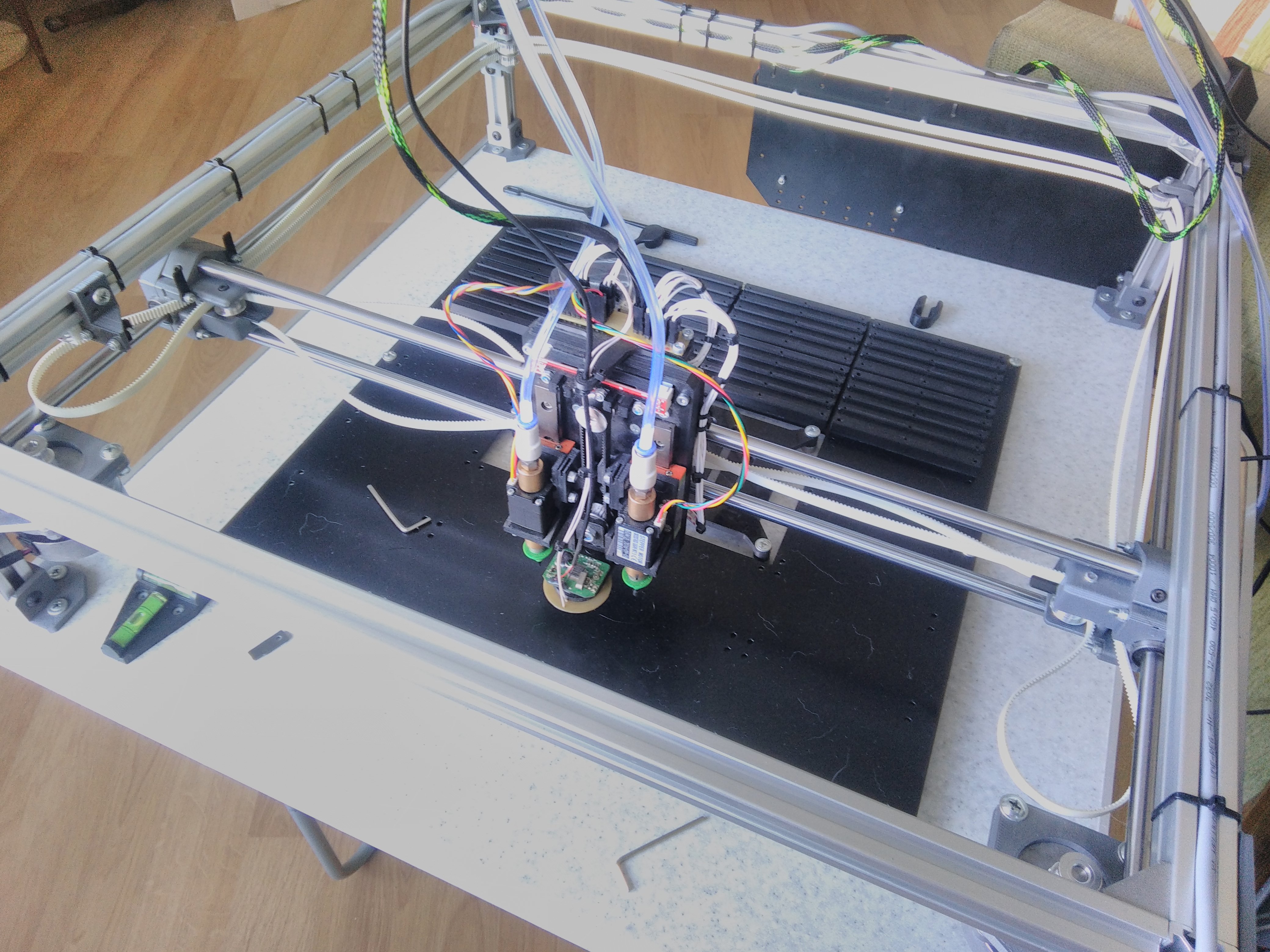

I build corexy kinematic system with smothie. Image here:
Smoothie fleshed by last firmware and donwnloaded and writed to card last config.
Six optical end-stops (min
s and maxs on all axes).All triggering work fine! Use M119 command from pronterface, and trigerred all end-stops one by one. State 1-0 changed. Untriggered = 0, triggered = 1.
I disconnect belts for prevent damage mechaniks.
AND!
Homing procedure work ONLY when “arm_solution cartesian”. And work FINE. Motors stops when end stop triggered.
When I write in a config “arm_solution corexy” and “corexy_homing true”, when I try to do homing the motors rotates without stopping when end-stop triggered.
It feels like end-stop just doesn’t exist…
I dont understand problem…
