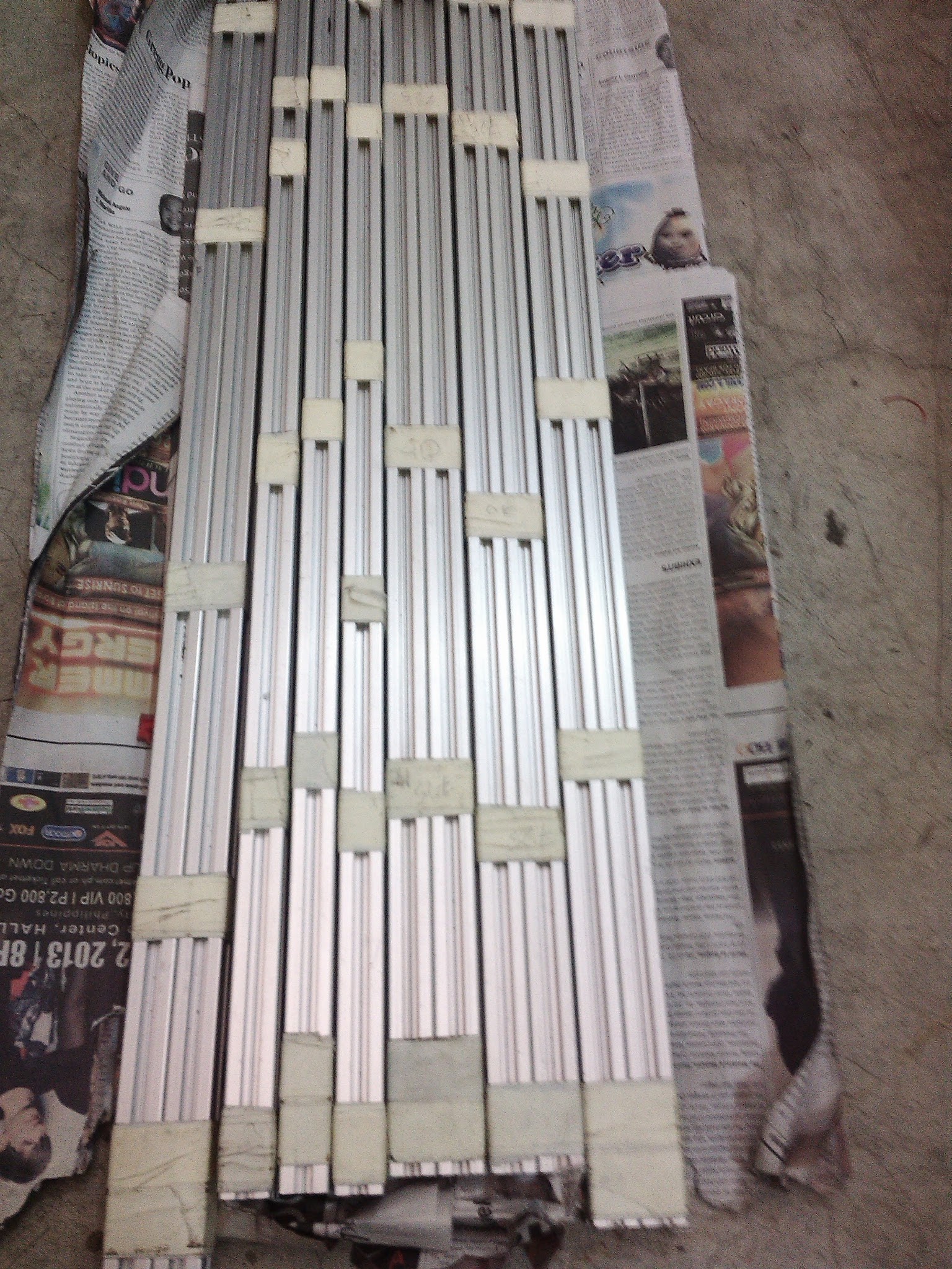

COREXY with an Ingentis frame. 24 x 24 x 24.
COREXY with an Ingentis frame. 24 x 24 x 24. Well the start of it anyways.

So is the frame solid? I’m looking at an exterior dimension of about 18x18x24
Yes the frame is solid. i am not sure how to answer your question about a size you are looking for.
I was more interested in the rigidity, as the build box gets better, it’s bound to lose rigidity, but the Ingentis looks well designed to keep that from happening.
I can only say i will have a more realistic answer later on.
