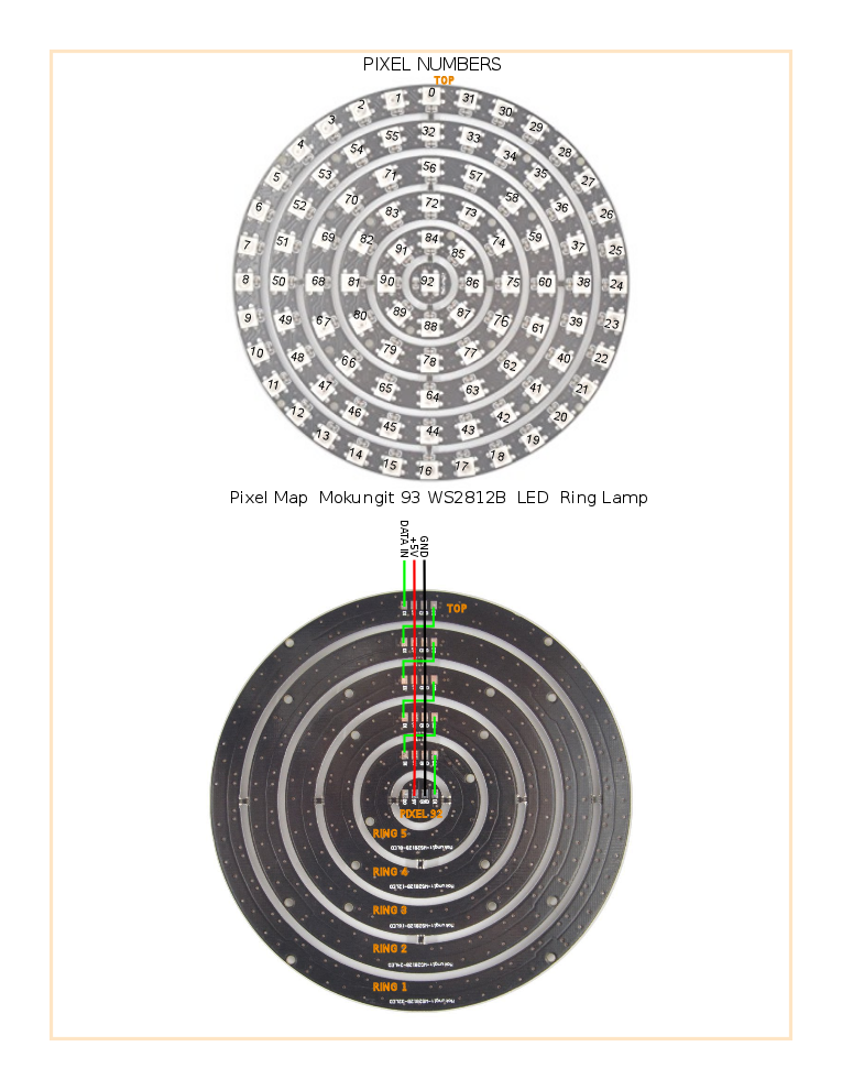

Corrected wiring for Pixel Map Mokungit 93 WS2812B LED Ring Lamp

It seems odd that the outer ring runs counter clockwise, but the rest run clockwise… :slight_smile:
Yes, the outer ring does run opposite to the others. That threw me at first and made for some weird patterns. I’m using this in a game for my grandkids. I started with the Neopixel library, but decided to learn the FastLED library as it will do many more effects faster.
Hey, I just re-checked the Led order on the outer ring and I see that I have it wrong. All rings go clockwise. All of the effects I did in my application were symetrical about the vertical axis, so the error didn’t show up. Here is the corrected drawing.
