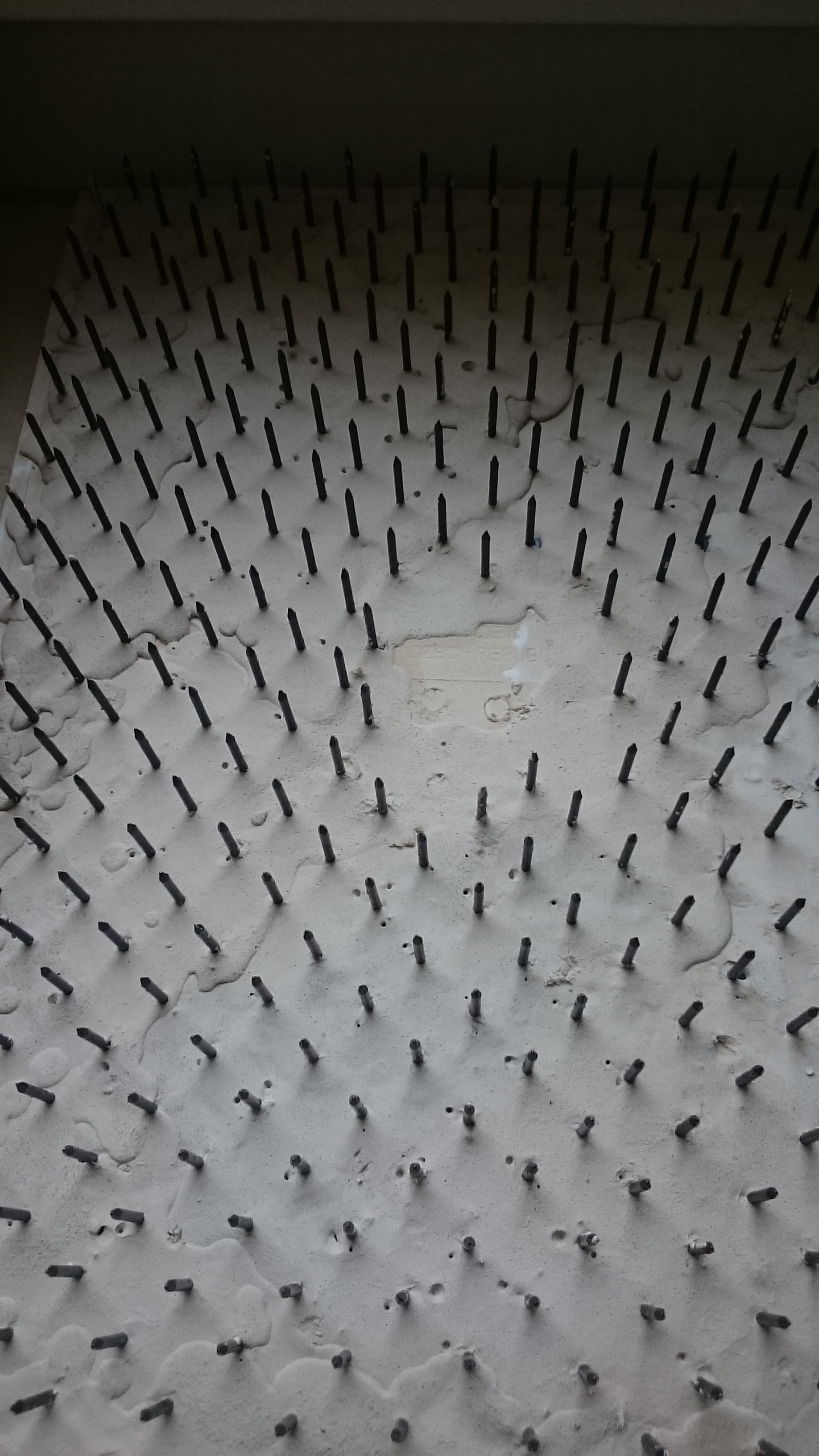

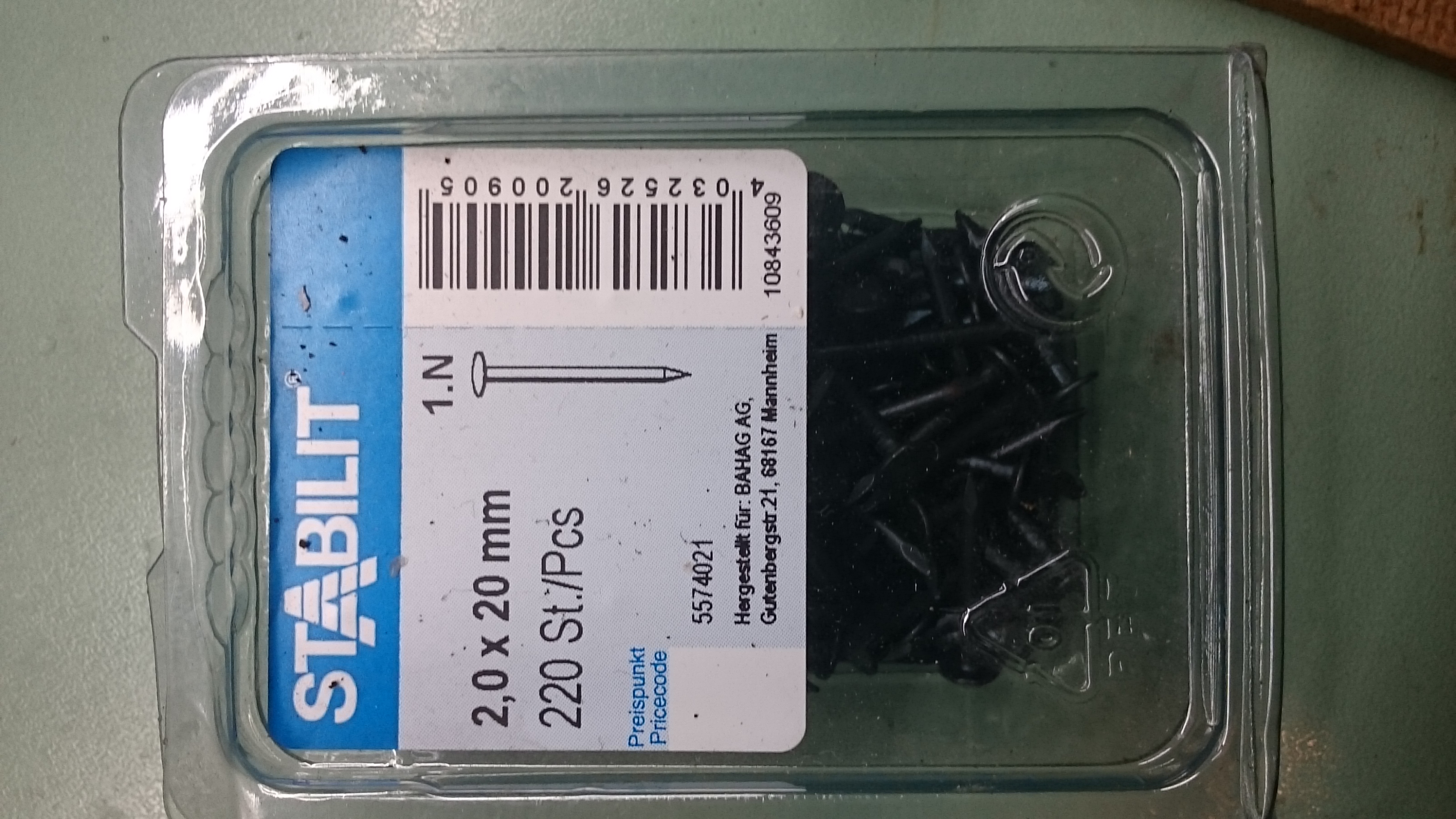

I’m using the same principal with an even more cheaper solution: using a tile (bottom side up) and super-glue nails with totally flat nailheads. Optionally you can fix the nails with a thin layer of plaster. I’m very happy about this solution because I have practiacllly no reflection destroying my workpiece . The (black) nails are coming from a hardware-store in germany (BAUHAUS).
@java_lang now that’s dedication, how long does that take to make?
@Andy_Shilling Well, it was a hard hour or maybe two, but it was worth, I’m using the bed one year now…
@Andy_Shilling One more advantage of using a tile was that I didn’t have to mark the nail positions, because there was already a (diamond) structure with the wanted spacing. So I could immediately start with gluing
