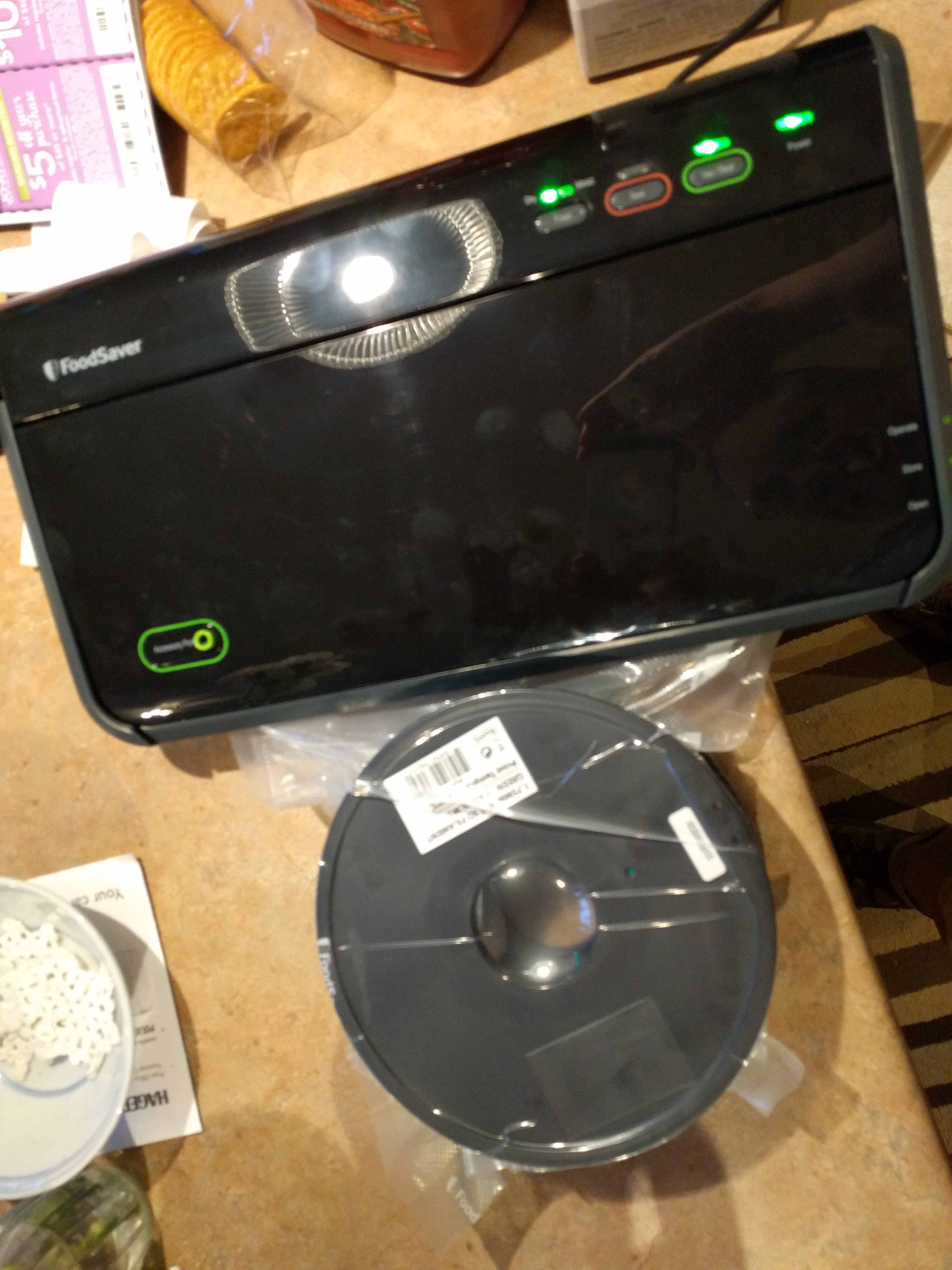

Costco sells vacuum sealers for $80...guess what else they're good for?
Costco sells vacuum sealers for $80…guess what else they’re good for?
Haha nice! does it come with the sealer?
It comes with some sample reuseable ziplock bags, and a small roll of ‘make your own’ bags…Costco sells at lifetime supply of bags for another $20.
I have several rolls of filament sitting next to my printer. I don’t understand the value of vaccuum sealing them. Can you help me understand?
@Phillip_Bell 3D printer filament is susceptible to moisture. It makes the filament brittle, and can hurt prints. Vacuum sealing it keeps the filament from getting moist.

@Phillip_Bell imagine snapping filament inside a filament guide tube after 3hours of print and still 5minutes to go
How about a food dehydrator?
@Mark_Ellison time is the essence :wink: If you are lucky to be in a sunny part of the world I let them sit for days in a cardboard box with dessicant (wrote about it in http://www.tridimake.com/2014/08/home-made-filament-drier-box.html from which you get pointers to better techiques, e.g. check the link to nylon printing). Some people also used a lightbulb in a box, etc
You can dry filament in a food dehydrator? Good thing I have one of those.
@Sebastian_Schmidt really? mine comes sealed with the dessiccant packs in it. I thought that was standard procedures? I get it from makergeeks. No affiliation, just happy customer.
Mike is that esun or Inland Brand from Microcenter??
Microcenter…wanted to change out color before using up the spool.
