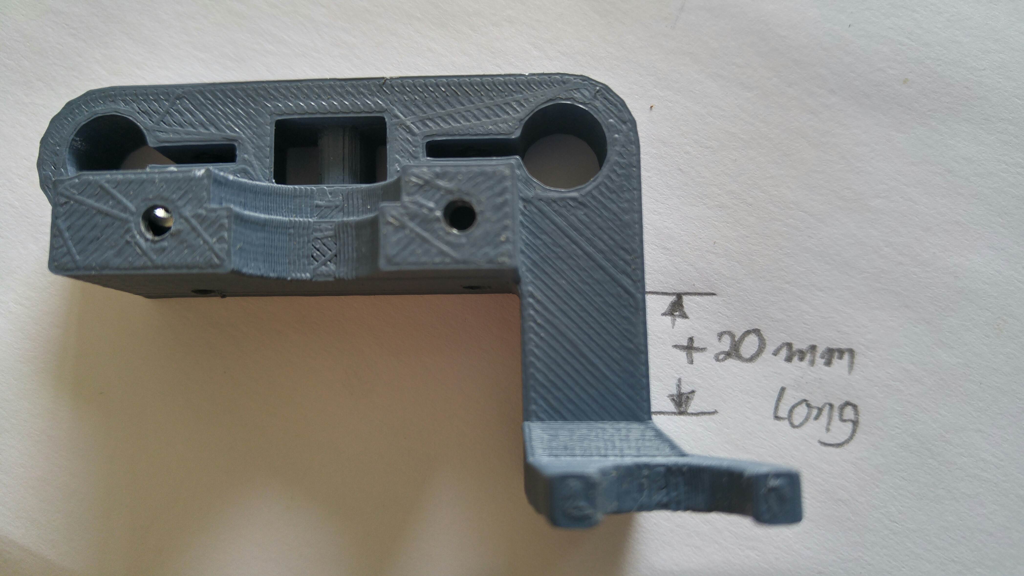

Could anyone modify an stl file for me? I know what I want but I don’t have the knowledge to do it.

blender can do it https://www.youtube.com/watch?v=eA5FQJAfAu4 different file, same concept: import stl, tab into edit mode, grab vertices, press G then Y then -20, tab out of edit mode.
and your file
https://drive.google.com/file/d/0B6INQmg_kjkhU2VGRHAxbjNWUzA/view?usp=sharing
@Olivier_Bilodeau Here you go http://www.thingiverse.com/thing:1741465
Try this: http://hoxnet.com/Carriage_stretched.STL

thanks all, sorry for being late to answer, didnt receive notifications

Try Fusion 360 for this. You can import it as a mesh and manipulate it that way. Though there is a slight learning curve if you have never done it before. But it’s probably the best way to work with .stl files, especially 3d scans and files with many faces.
Take OpenSCAD, i think, this object needs only 30 lines of Code with parameters, so you can change sizes very quick. Give me a painting I will do it for you.
in general, ask the original designer to publish the original design file. STL Is an export for printing only that that only contains as list of triangles. All meassurements, constraints, names, dependencies, … are gone at this stage.
