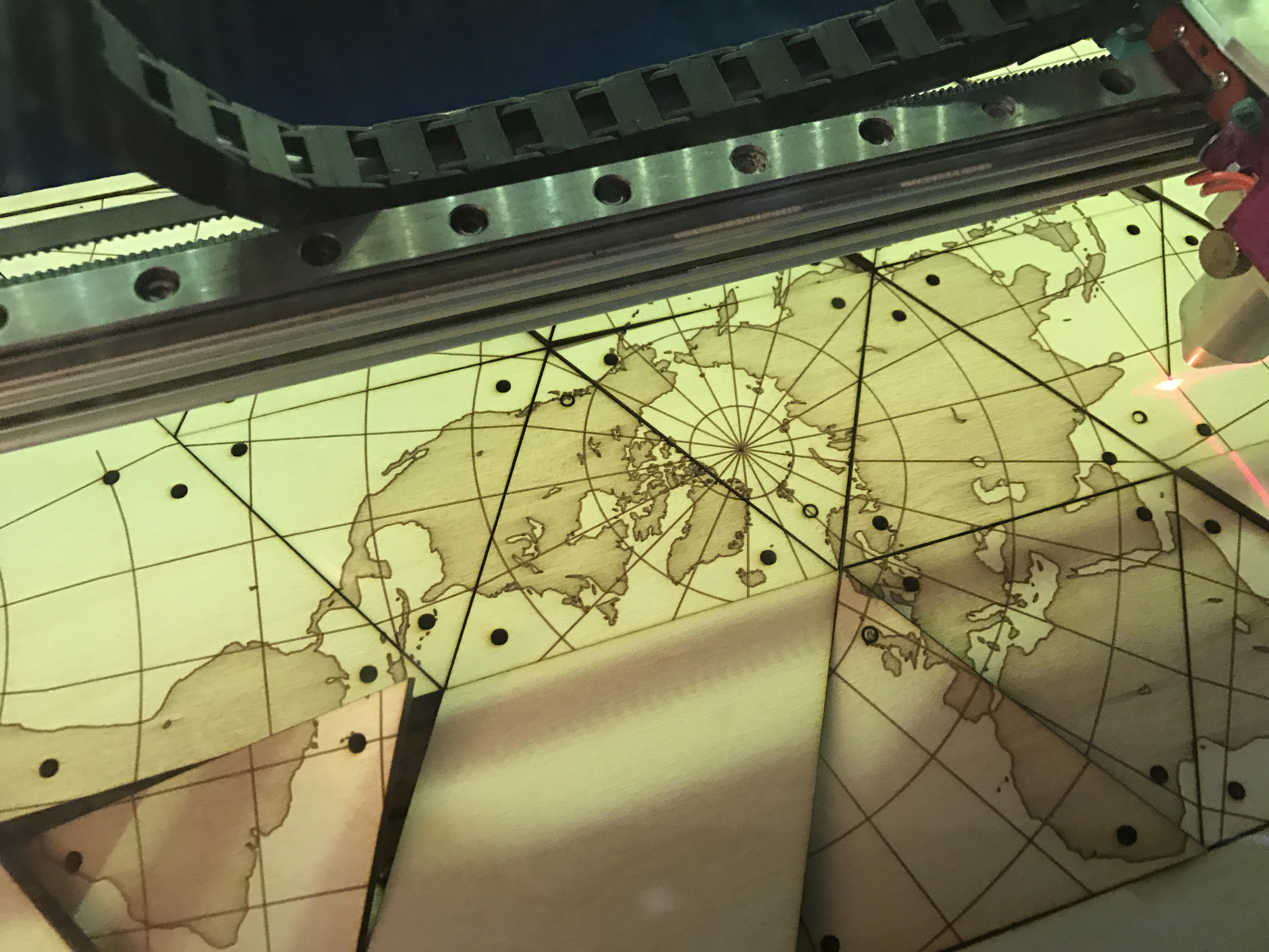

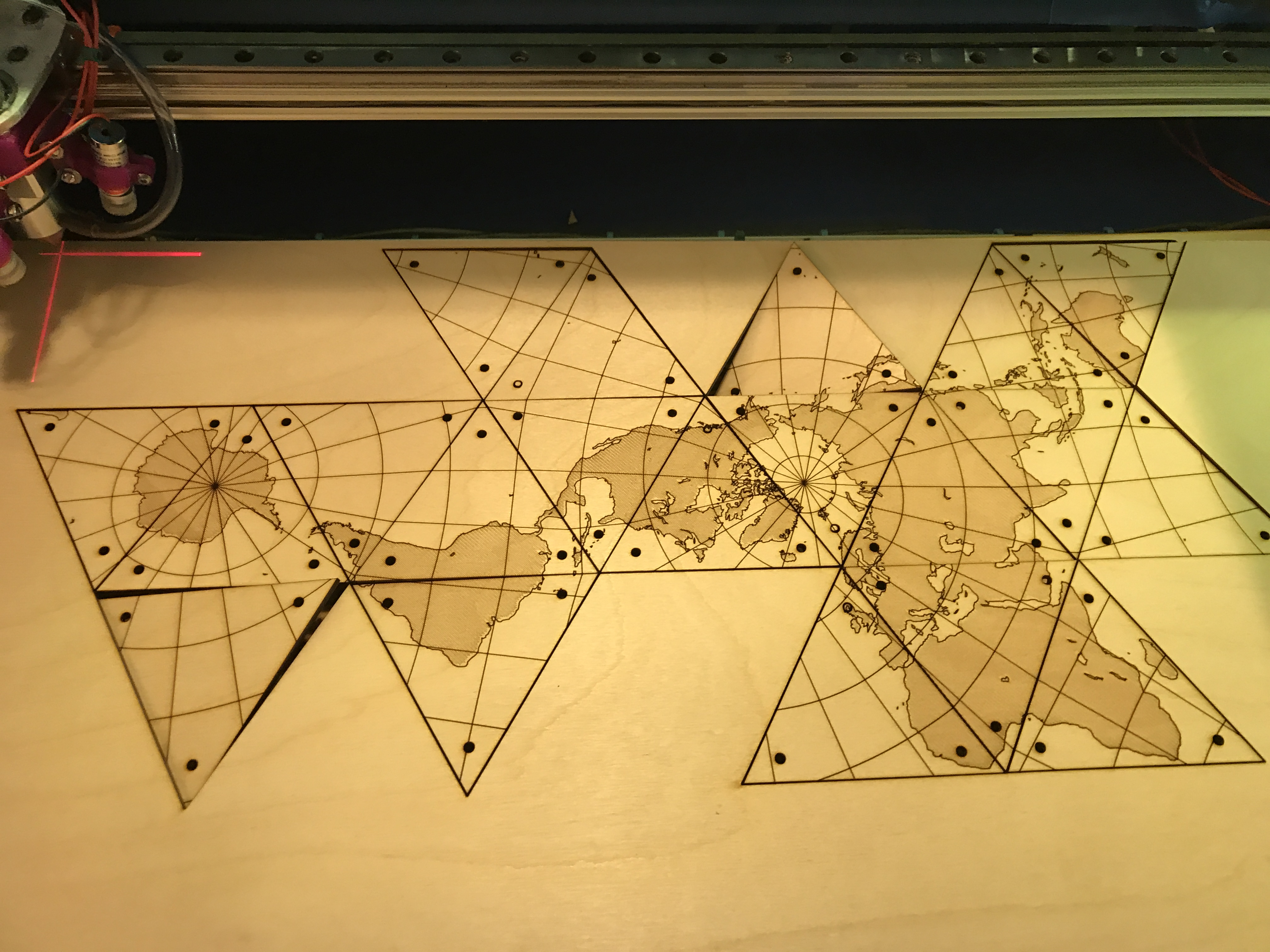

Here’s the finished map done with a bitmap for the country engraves. I couldn’t get the bitmap to line up for some reason.

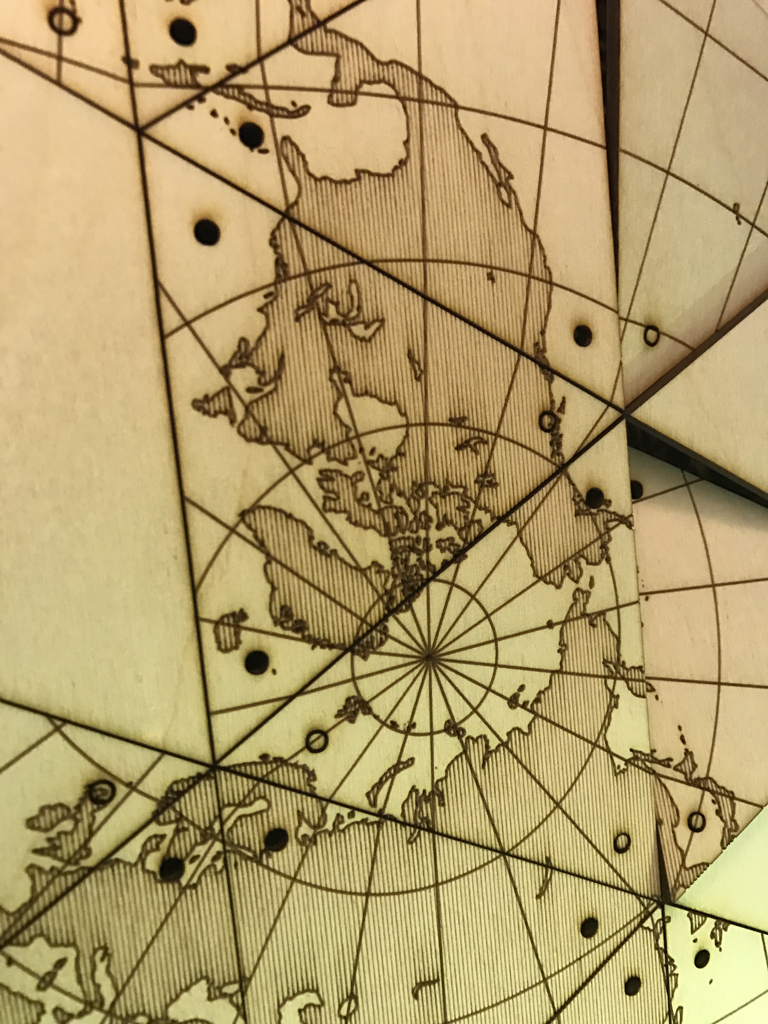

Laser fill works great!
Increasing the beam diameter/scan gap makes for a neat effect.

Here’s a better one showing the increased scan gap. I think I posted the wrong photo above. And just for future reference, I’m a she. :slight_smile:
@K1111 That’s a neat effect.
Gorgeous scanline effect there.
