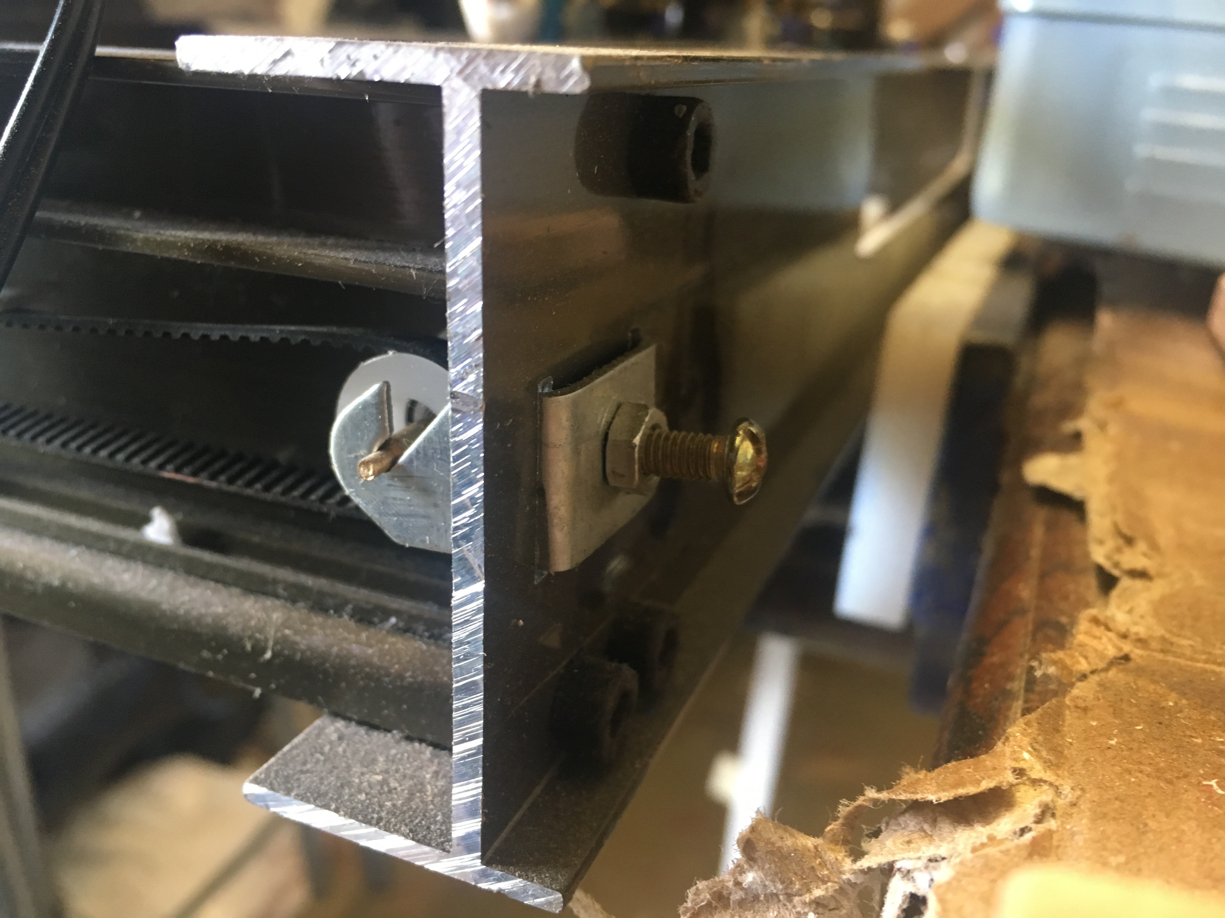

@SirGeekALot to tighten the y-axis belts there are holes in the back of the machine which allow you to stick a long screwdriver through to get to the belt tensioners on either side of the bed.
@Nedman Thanks! The X-axis did seem fine, while the Y-axis seemed much looser. I’ll have to look for the holes. I only recall one though…
@SirGeekALot Hi James, there are 2 holes, about 1cm dia and the tensioning screws are about 120mm from the hole … remember those ducks at the fairground you had to hook, and never could, well, finding the head of those tensioning screws is a little like that … impossible.
I found It helps to reach around through the bed to guide the screwdriver to the screws. Left side is easier then right but just getting a finger on the screw helps. Or putting a light in the back of the bed should enable you to look through the hole to see the screw head.
