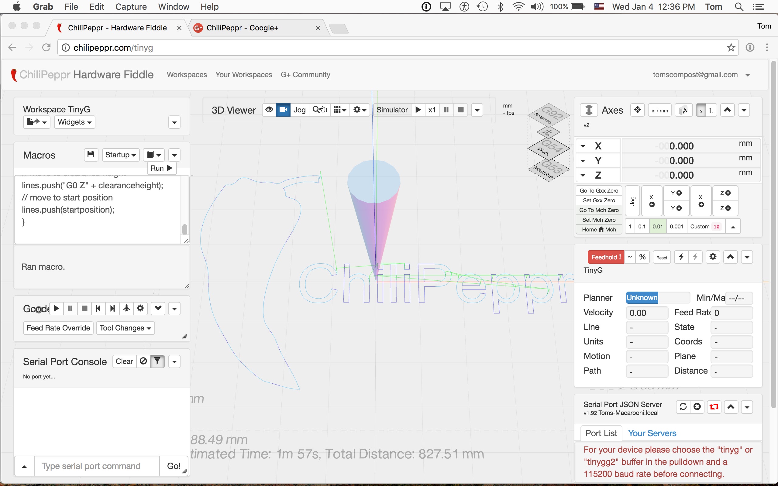

Could someone help me with repeating code? Maybe it is called "block" code?
50 passes gives me a 1/4 inch deep pattern. Yep. It sure is slow, but it’s the only way.
Here’s a macro that’s close. Here’s the output.
// This macro takes your block of gcode and repeats it over and over for each z step. Please
// specify what size of zstep you want, and your start and end z position.

That sure looks a solution. Maybe tonight’s the the night this thing succeeds. Thanks! I’ll post back.

Occasionally when I load a new curve the ends have a large almost circle attached to them and I don’t know where on earth that comes from. Luckily they are usually okay.
I take it the need for the shallow cut is partially to prevent rough edges. Can it be cut deeper in areas that you can cut further from the intended cut location for a rough cut? I am curious. I am still pretty much a newb at this stuff myself.
Now that I look, it’s present in your image. that same file doesn’t generate that anomaly when I run it my usual way. So weird.

John saved my sanity… at least for a while.
The macro worked well last night. Thank you John! Now if I can solve the strange rendering issue…
I’ve had some time to get comfortable using the macro you wrote John. I’m able to adjust the variables taking stock thickness and cutter profile into account. One last sticking point exists. As the machine returns to the home end of the curve pattern, the Z ramps down to the the start / origin. With material loaded this would not clear the workpiece. I’ve tried twiddling a dozen different things and running the machine to test but haven’t been lucky.
To describe: Z height is proper through cut passes and raises to clearance height when cut pass finishes. Z height ramps to start position on return rather than traversing the full length at declared clearance height.
What is left to try?
See macro below-

Is it possible I’ve changed something that would cause the macro to not render when I press run? Currently, it all looks like it should but the Chilipeppr file stays in the field. Ive restarted, reloaded reattempted everything I can think of.
Installed Chrome…no luck.
Has anyone else seen this behavior? No script will load in the macro space.
Can you post screenshot?
Looks fine. You dropped the code that actually sends your Gcode string to the workspace. When I sent you that code snippet you were supposed to just replace that specific block of lines, not remove everything.
Yes. Only the the snippet with the added function was changed. However, other previously working codes won’t load.
