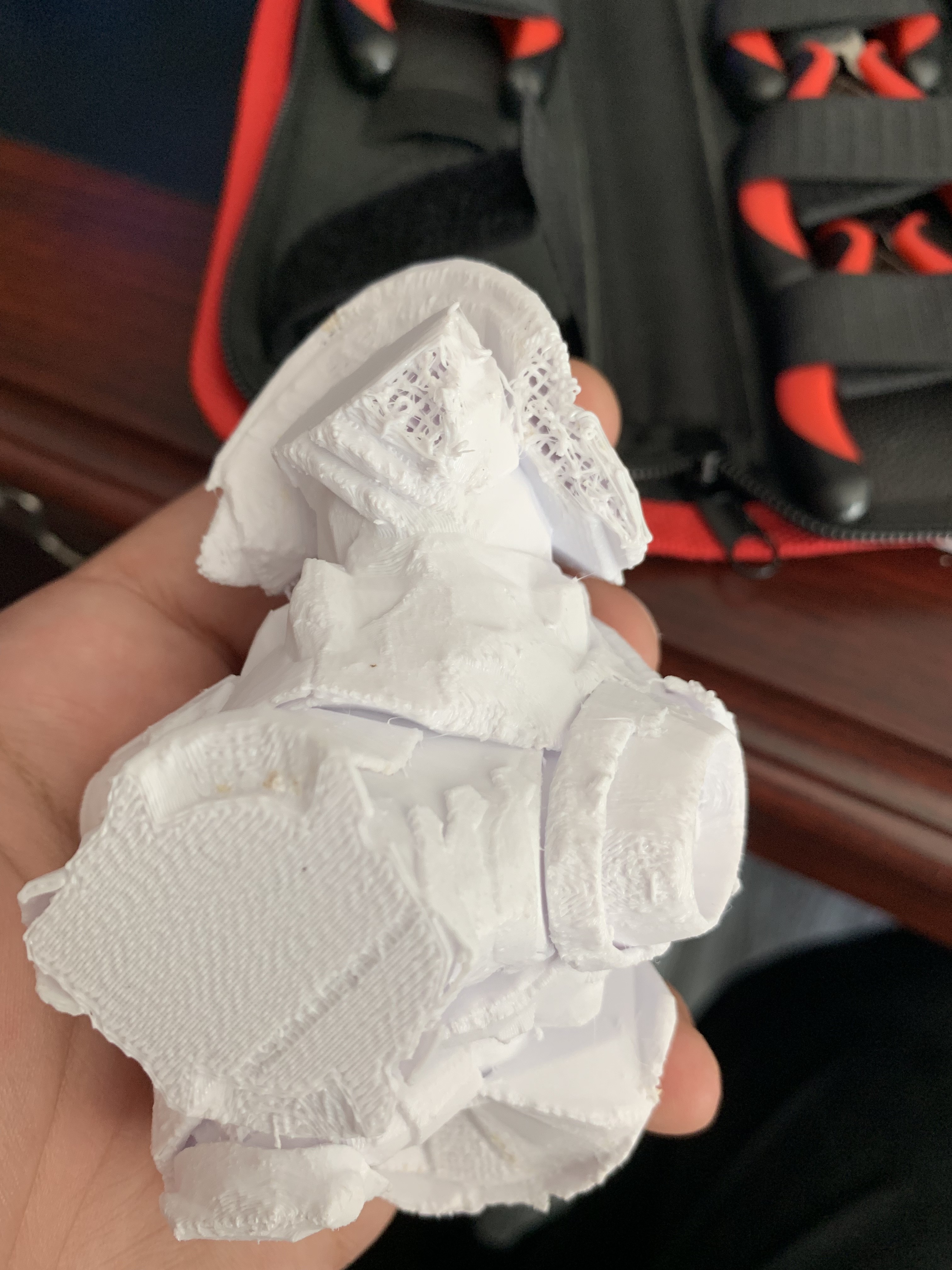

Could someone please explain to me why this is doing this, and how to fix it. My temp is at 205, and set retraction to 3.5mm. This is the bottom of my print.
Try using a 1.5-2 on the retraction, maybe lowering your temp and a slower print speed. This should give you more control of the print.
