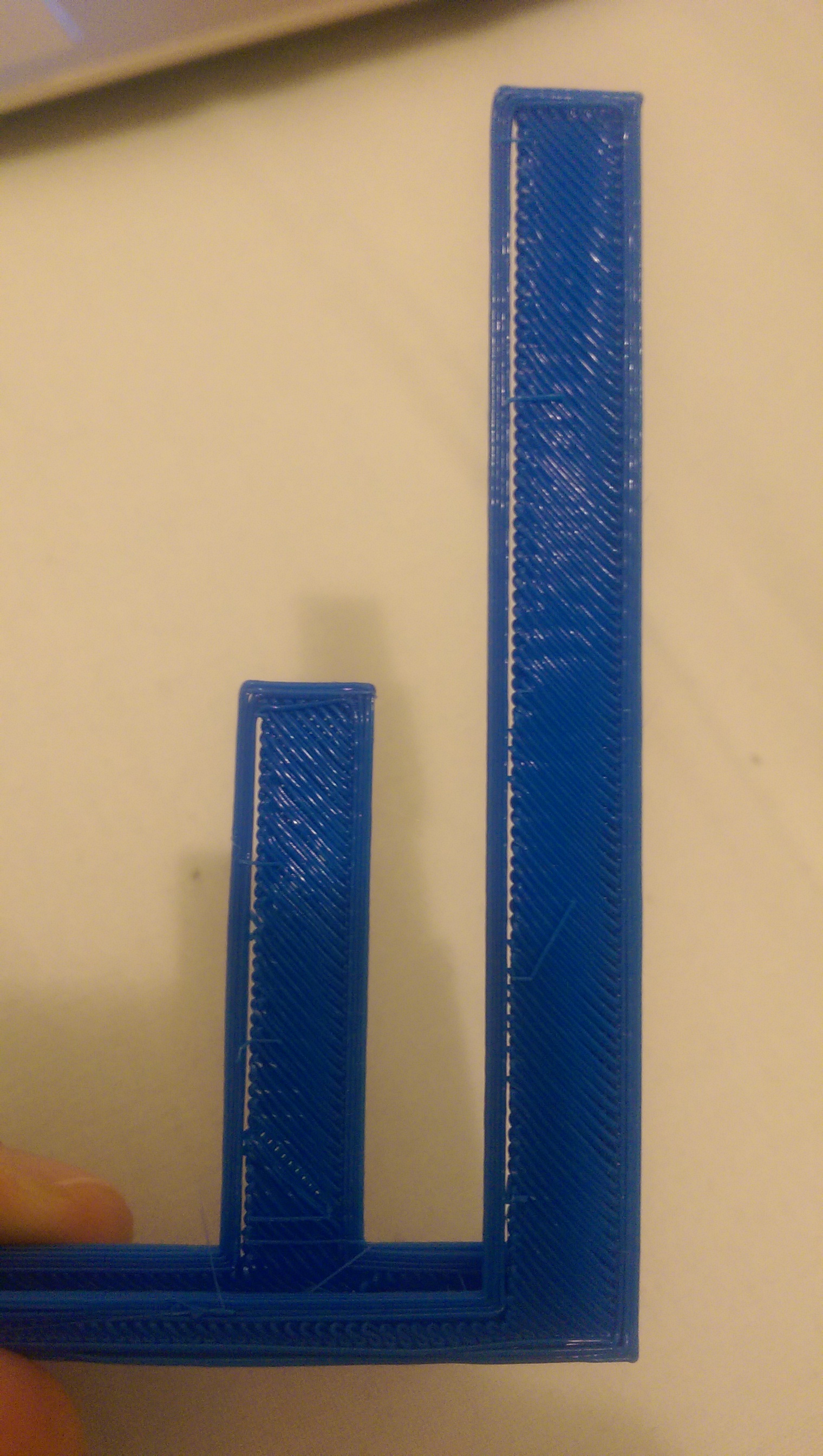

Could someone suggest what's going wrong with this print?
Could someone suggest what’s going wrong with this print? It seems like the perimeters aren’t joining up with the fill for the tip and bottom layer properly and I’m not sure why. It only seems to have happened on the left hand edges.
Printed in pla on m3d micro using their slicer (cura with unknown settings) at 215c.
Classic sign of backlash in the belts. Check that your pulleys have their set screws tightened, check that your belts aren’t too loose.
He’s right. I had the same issue once before
Thanks guys, I’ll check that one
