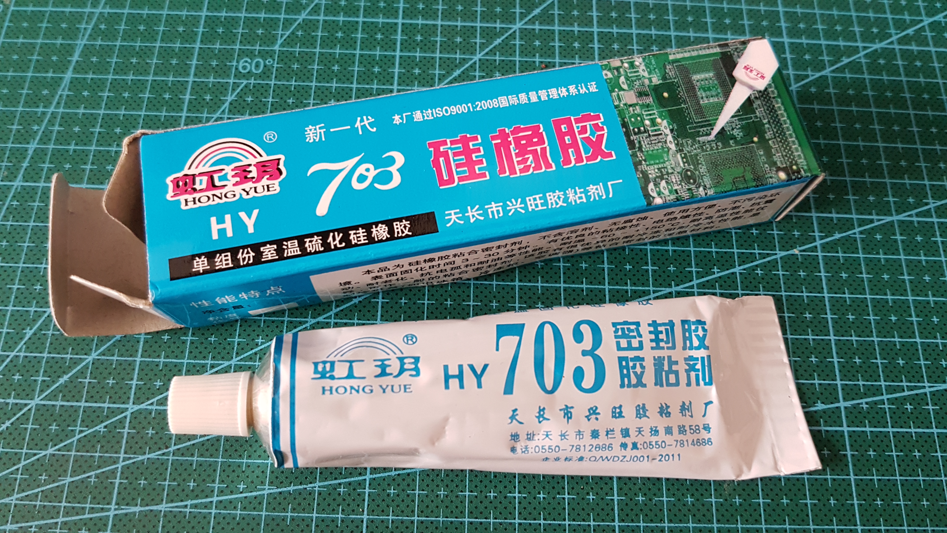

Could someone tell me what this pasta tube that comes with the machine might
Could someone tell me what this pasta tube that comes with the machine might be? Trying to translate what is in the box, it is a paste for cooling circuits, but in the picture of the box it looks like they are pouring the paste on a PCB board. Did someone else come with his machine?

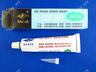

it is silicone to cover the hight voltage connexion on the tube in case you need to change it. (to avoid arcing to case)
@StephaneBUISSON Ok. Perfect. Then it is a thermal sealer to coat the contacts in the tube. Would it be logical to use it also on the PCB board in the fuse and the AC contacts?
No - those are not HV
@Fernando_Bueno its not a thermal sealer it is High Voltage insulation used during tube replacement as @StephaneBUISSON suggests.
It’s a liquid rubber.
703 rubber silicone anti lighter arcing spirit high pressure cap seal glue 35 g
http://s.aliexpress.com/M3Ibuuqu
(from AliExpress Android)
never looked this up before, and this link has some specs:
Interesting: Dielectric Strength of 16KV per mm.
