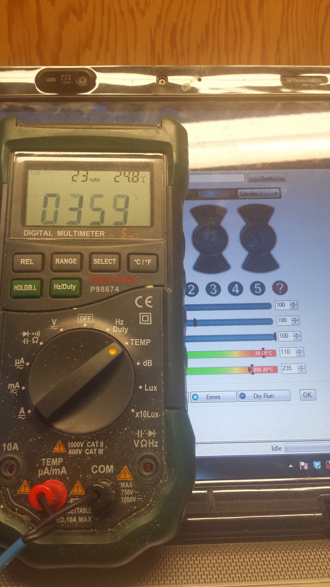

Could this be the reason my bulldog XL extruder is slipping. This is the temp of my E3D hotend. Does it get harder to extruder the higher the temp. Hotend suppose to be 235C and reading 360C. I know in the video my extruder is skipping steps. Ive tried tunning the pololu with no luck. http://youtu.be/_v-U6uWGefw
I had the same problem when my extruder’s thermistor died. It failed reading 25C. It looks like the printer thinks your temp is too low, and is sending full power. When this happened to me the extruder was damaged.
This is a all metal E3D hotend and should be just fine at this temp. Im using ABS for my plastic and Ive noticed it smoking before just never thought of it. Ive been looking around and it looks like the thermal couple came out of the hole. Still wondering if it becomes harder to extrude at higher temps
