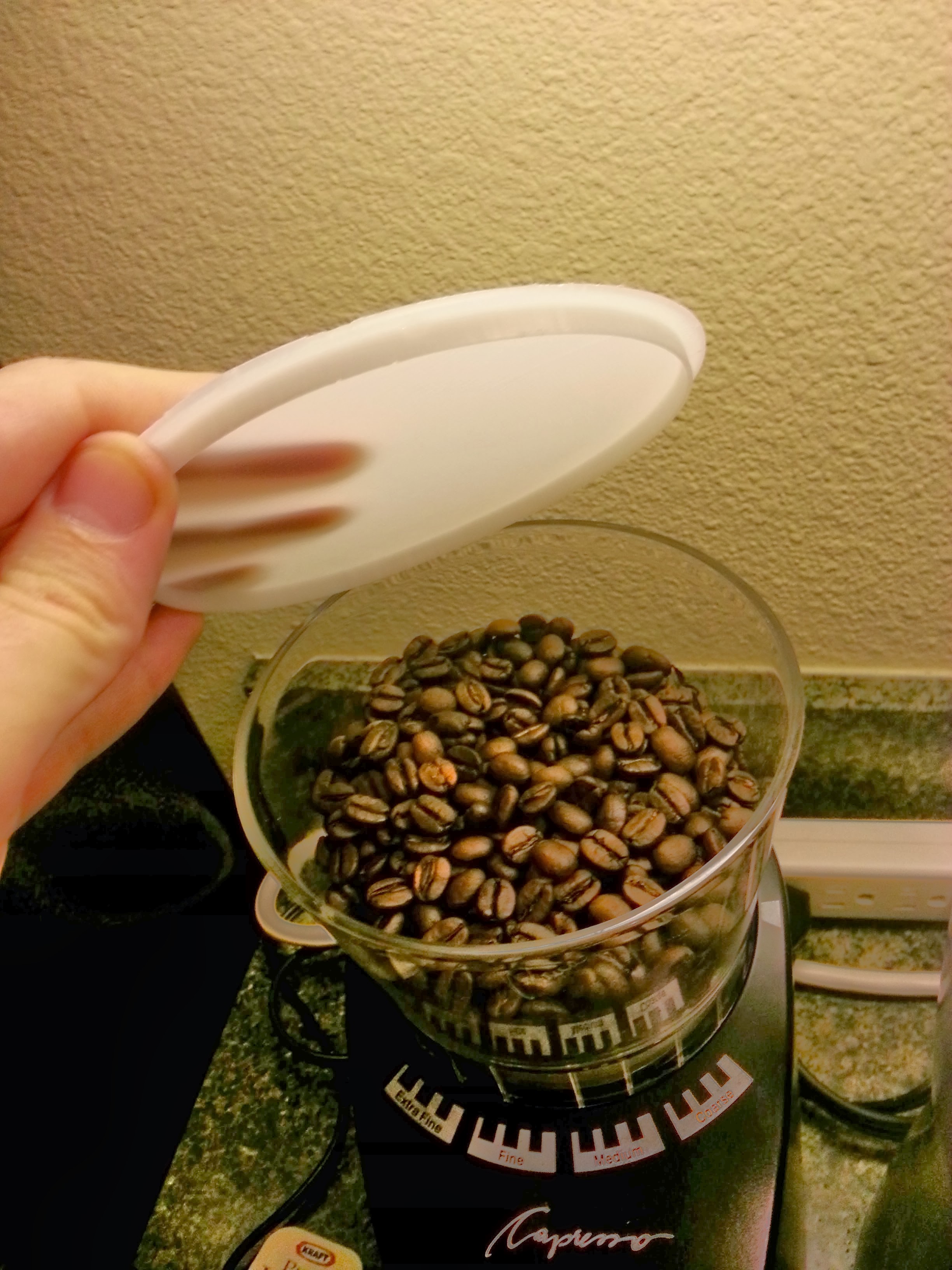

Couldn't find the (cracked) lid to the coffee grinder.
Couldn’t find the (cracked) lid to the coffee grinder. 3D printing to the rescue! (Nylon 618)
Great job. Don’t you love the flexibility to fix things yourself.
looks awesome! any link you used to build the rostock?
@Ben_Jackson it’s great! Less than a minute in openscad and I had a working lid design and was warming up the printer. Replacements are actually available for purchase but why bother when I can print one faster and cheaper??
@Roberto_A_Diaz I got the seemecnc kit for the rostock MAX plus the “add-a-struder” so I could go right to dual extrusion. So far, other than printing a new nylon hotend mount to go dual, it’s a stock machine.
If you’re interested in printing nylon on a similar rostock machine, I use an unheated glass bed and these gluesticks: http://www.amazon.com/gp/product/B001PMJYAO/ref=as_li_ss_tl?ie=UTF8&camp=1789&creative=390957&creativeASIN=B001PMJYAO&linkCode=as2&tag=rpgtab-20
They are so good I even left my first Amazon review about them. Just make sure the glue is completely dry before you print. Some glue will stick to the nylon, that’s fine, it’s water soluble and a quick rinse takes it off.

@Ben_Jackson I tried a few things without success and read about the gluestick idea. The first no-name one I tried technically worked but gooped too much and the printhead got all covered in bits of glue! The ones I linked glide on in a nice even and thin layer, no z-offset needed. You can heat the bed to 45-50C so it dries really quickly but be sure to let it cool down before printing, I haven’t tempted fate and tried >40C but it works well having the bed sit at 40. It works just as well off though so you may as well save energy!
