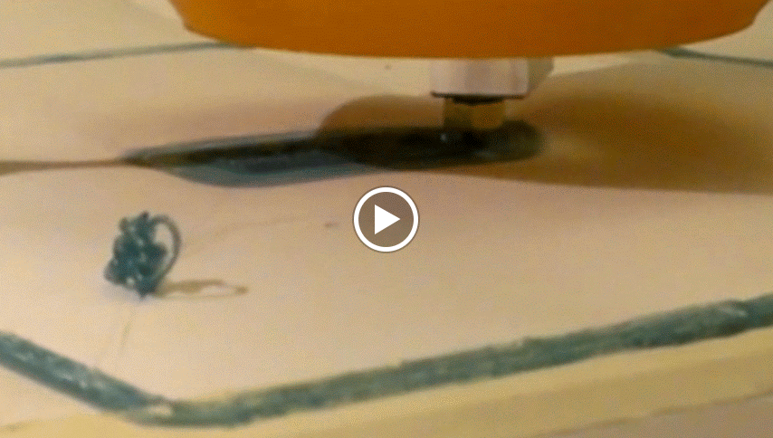

Couldn’t resist to wait any longer and decided to make a first trial. X and Y rods are still loose and still waiting for a heatbed. As a temporarily solution just printed on a loose sheet of paper. Calibration was limited to real basics (X,Y,Z,E steps). Sounds promising for the next steps.

Great learning today: both belts on the same axis should have equal or close to equal tension to avoid twisting of the gantry. This was the main adjustment I had to make after vertical and horizontal alignment.
