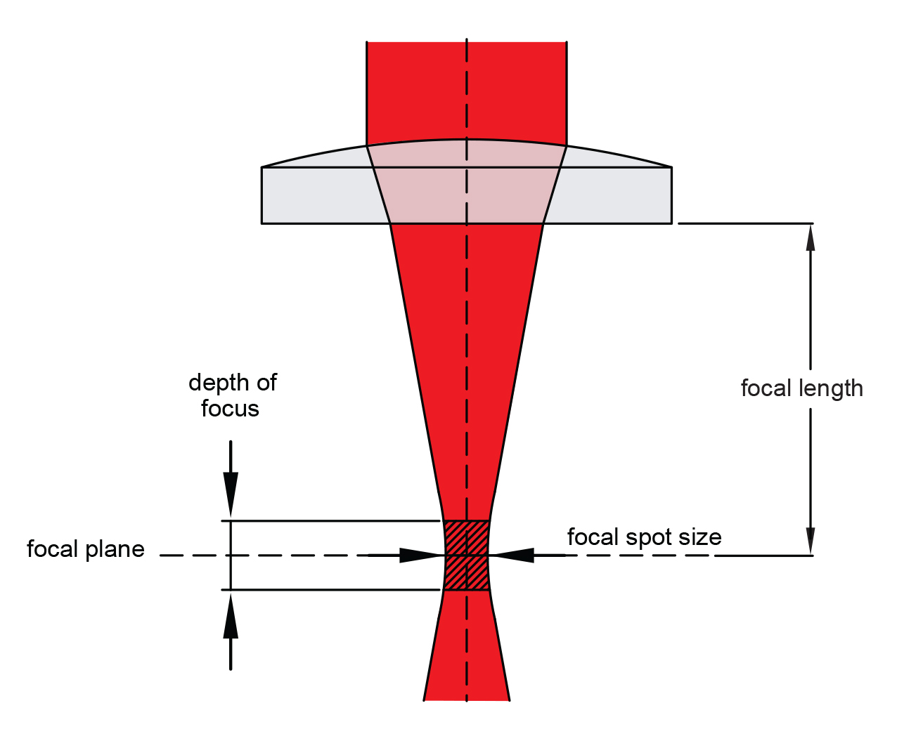

  2. How much focus effects your engraving depends on how small the details you are trying to engrave. If you are trying to engrave a photo quality picture then you want the focus to right at the surface of the work piece to get the finest details. If your details are bigger then you can be out of focus more. In my case I typically engrave and cut without changing focus so my focus is set halfway into the work pieces for the best cutting. So for 3mm material that means the focus is 1.5mm below the surface and I still get good detail engraving.
The beam actually has a waist and the length of the waist, or depth of focus, is lens dependent. The longer the focal length the great the length of the waist.
