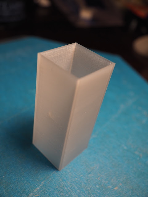

To see how spot-on @Michael_Coley 's Ares profile for CraftWare (http://www.easyarts3d.com/forum/viewtopic.php?f=21&t=5591#p33089) is, quality in this print is extremely uniform despite a 50ºC temperature range. (I’m posting a miniseries in this study.)

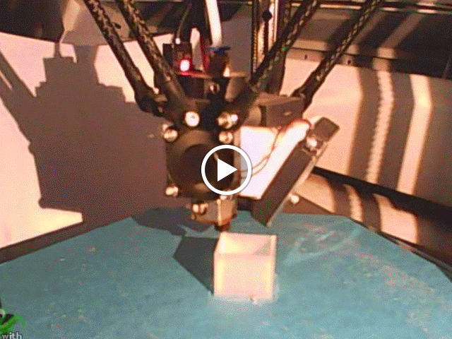

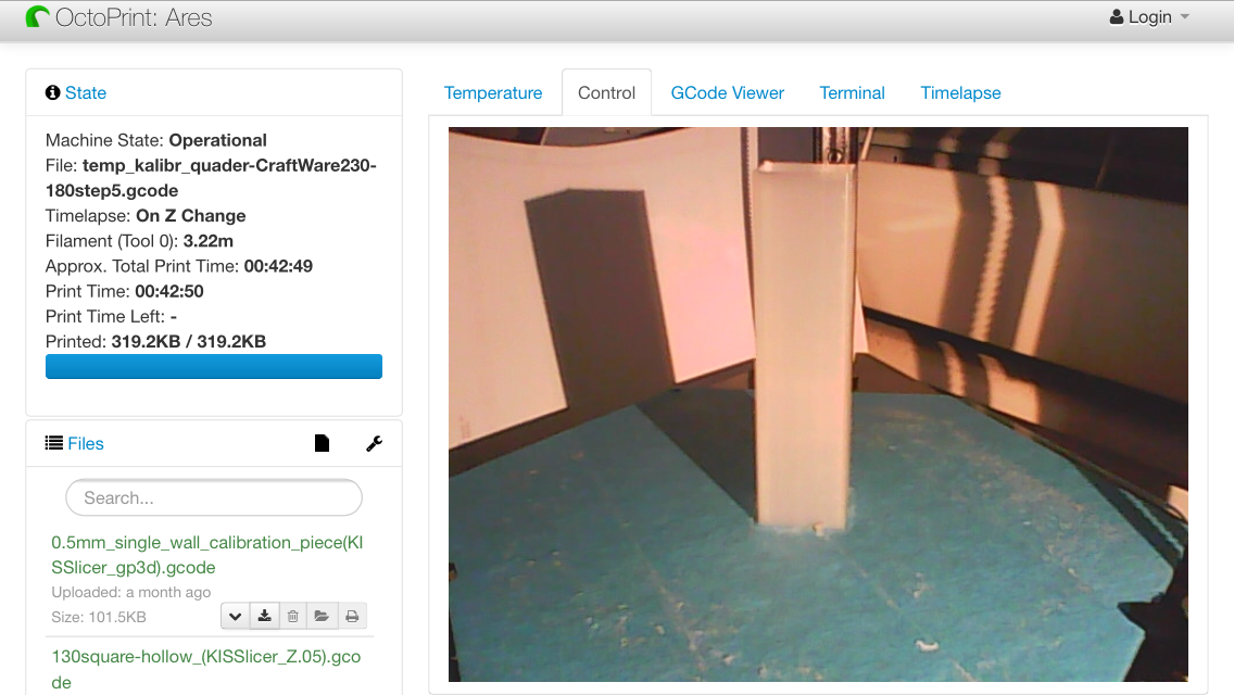

This was also the first time I took advantage of OctoPrint’s Web on the Internet. For security reasons, I do not allow Internet browsing into my network. But that morning, I knew that I would be on my shuttle by the time this cuboid finishes printing. So I set up my firewall to allow Ares 3D printer to be viewed from the Internet. On the shuttle, I watched the last few layers finish, took screenshots, even downloaded the time lapse video. How glorious is that!

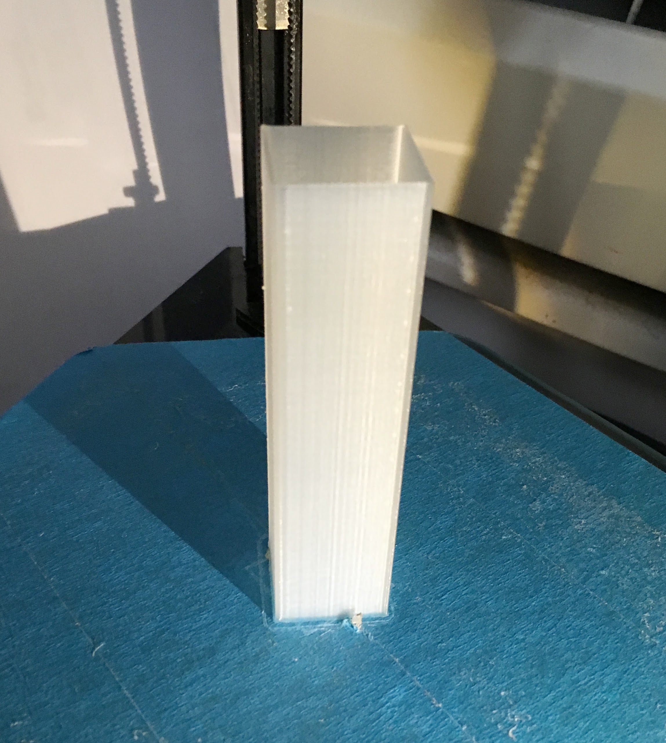

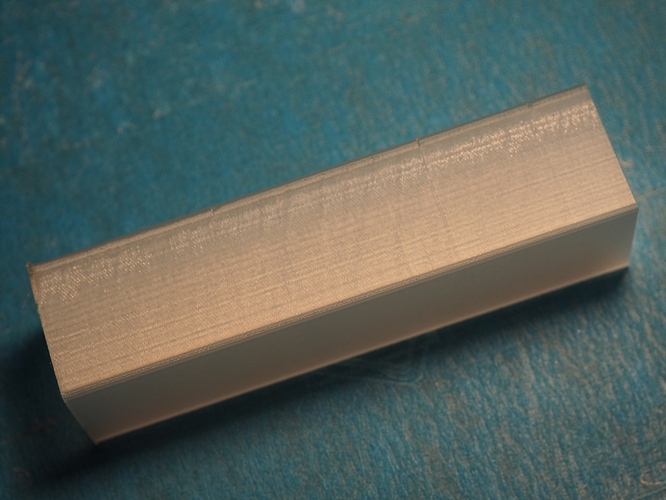

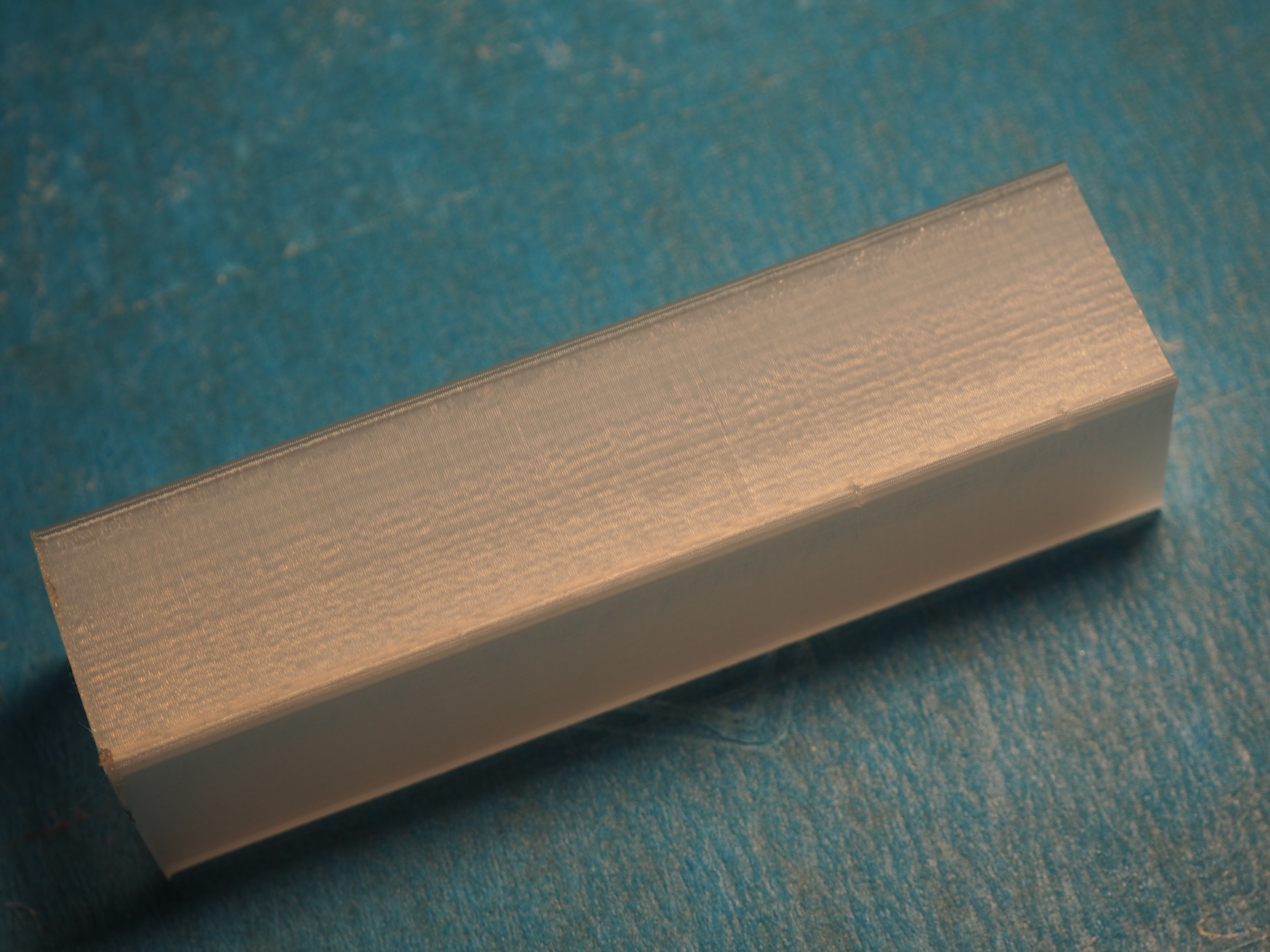

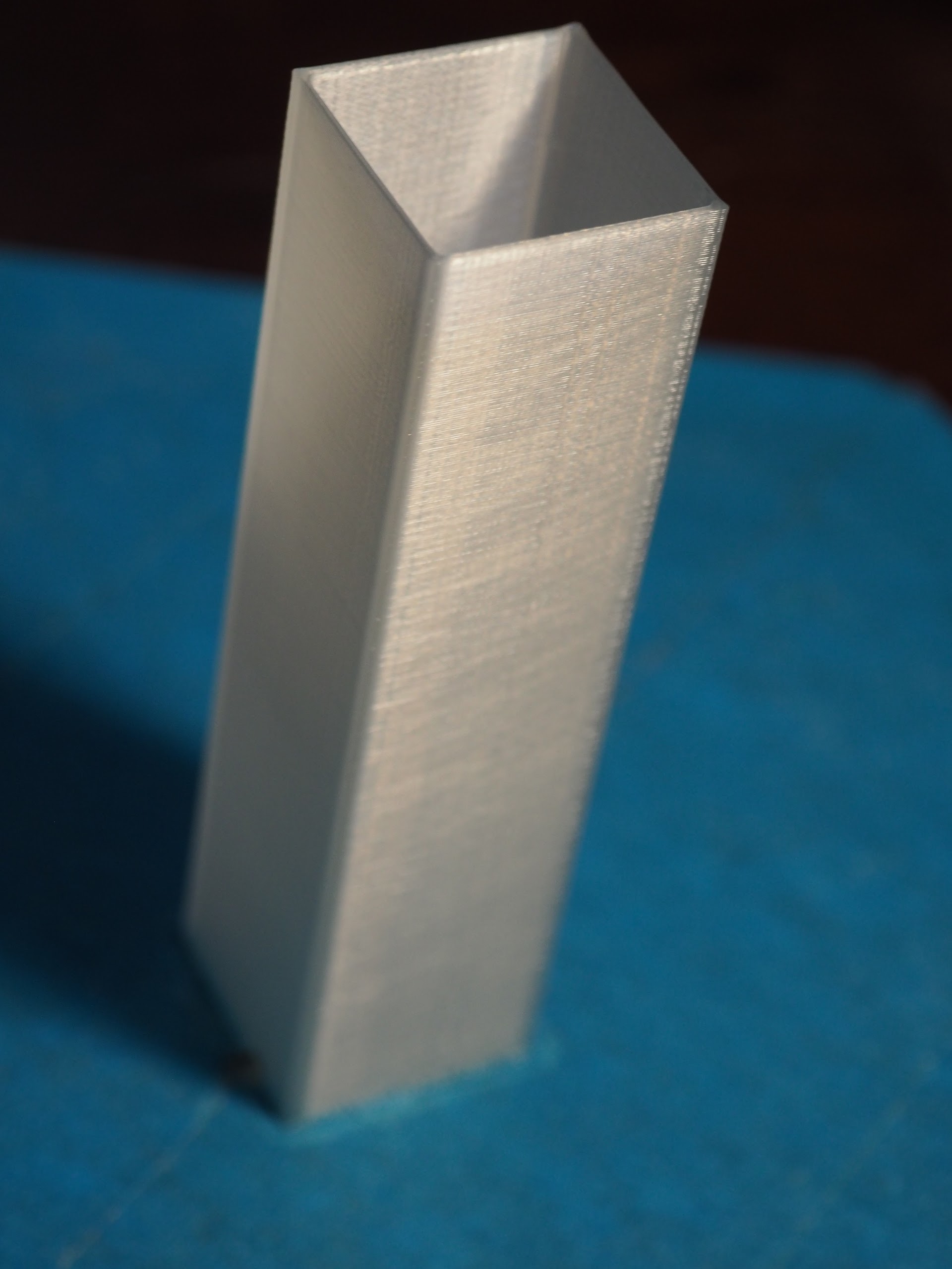

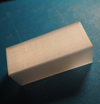

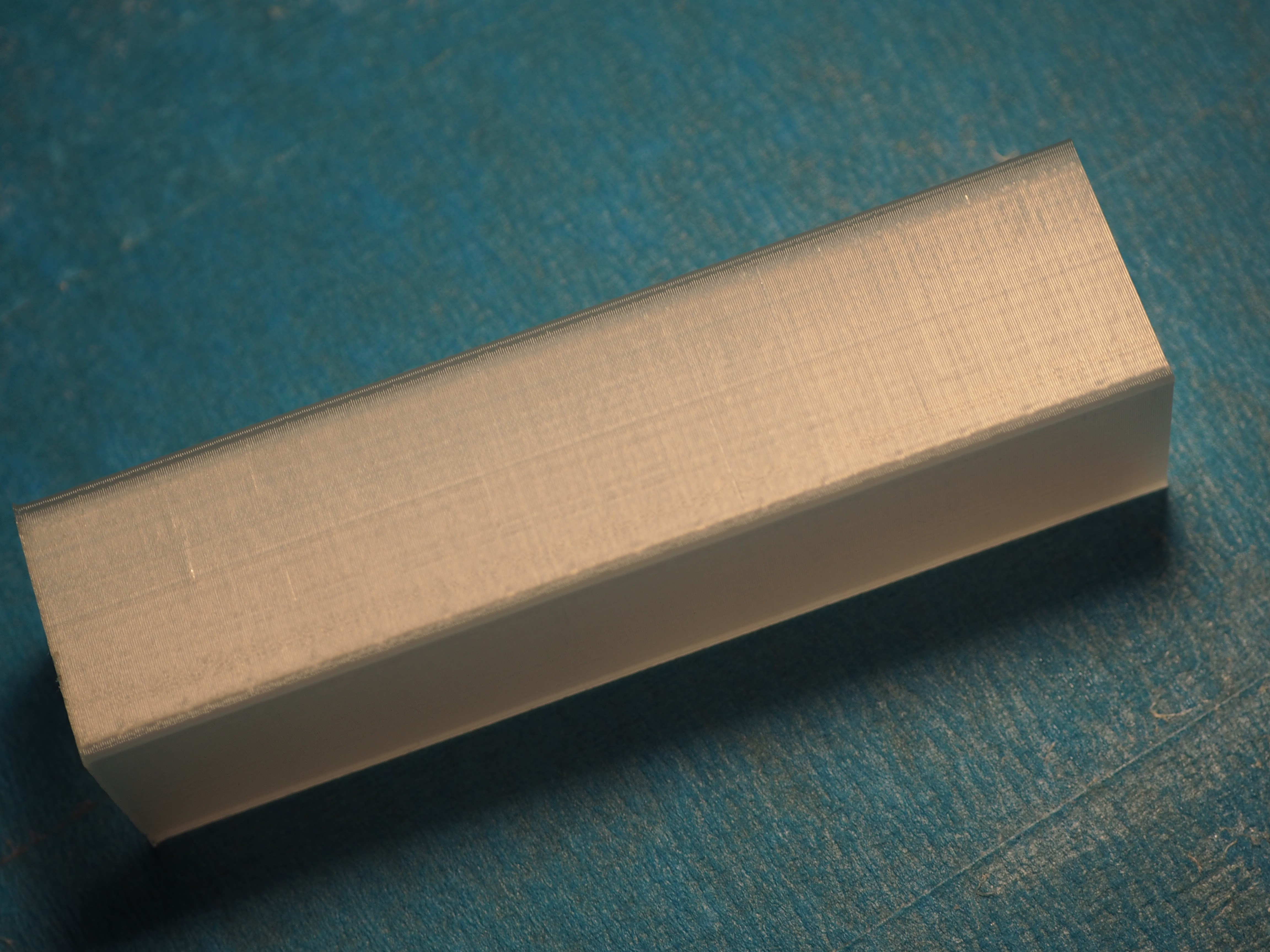

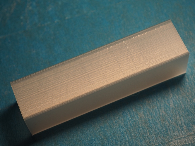

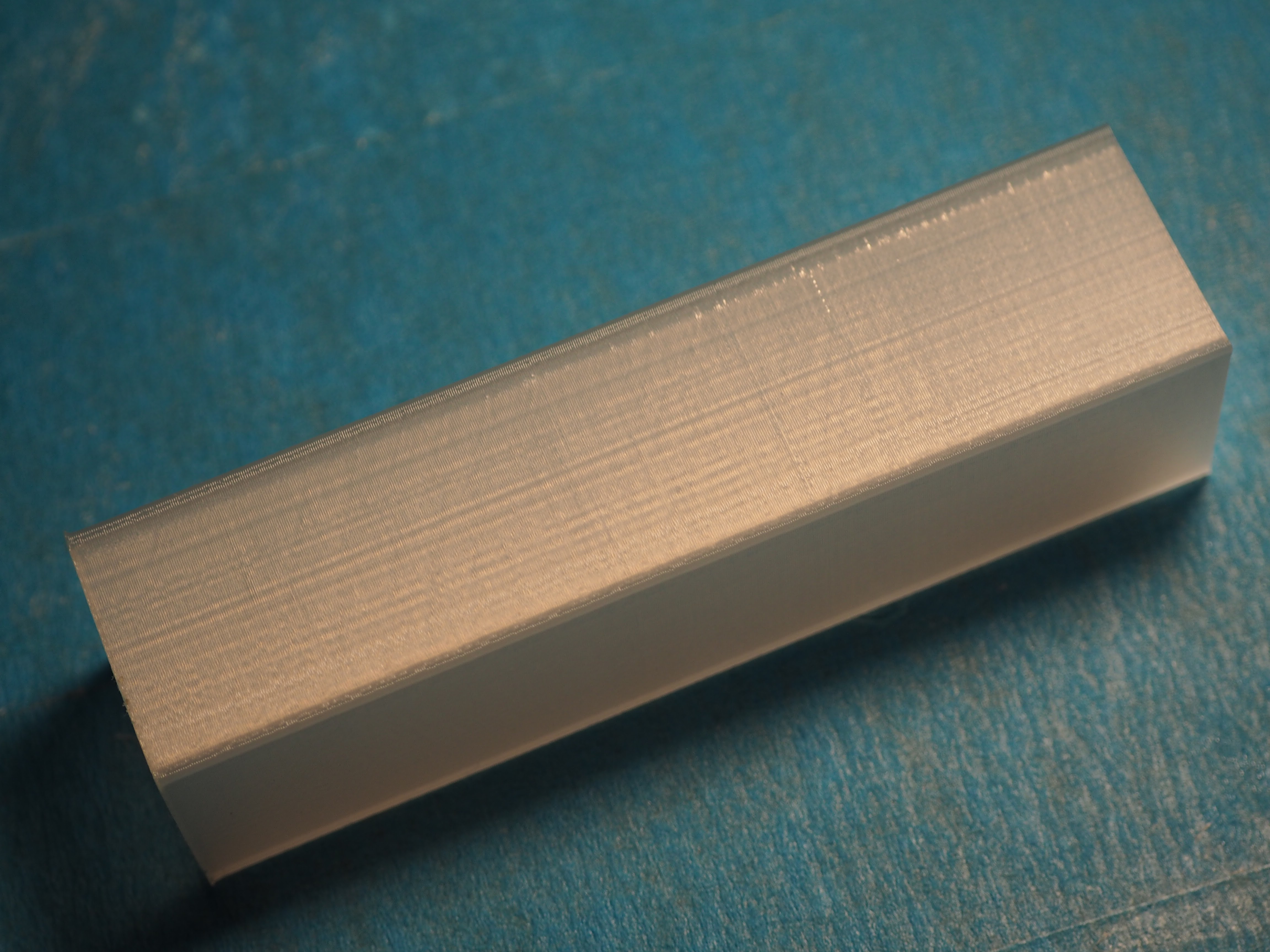

After I came back home, I couldn’t wait to examine wall quality. Unlike what the tutorial shows, however, there is no visible defects even at the highest temperature. Is Ares so good that it handles all temperatures equally well or GP3D insensitive to hot end temperature? (Part two of four parts - I know that I said three parts. But three simply won’t cut it. Stay tuned.)
