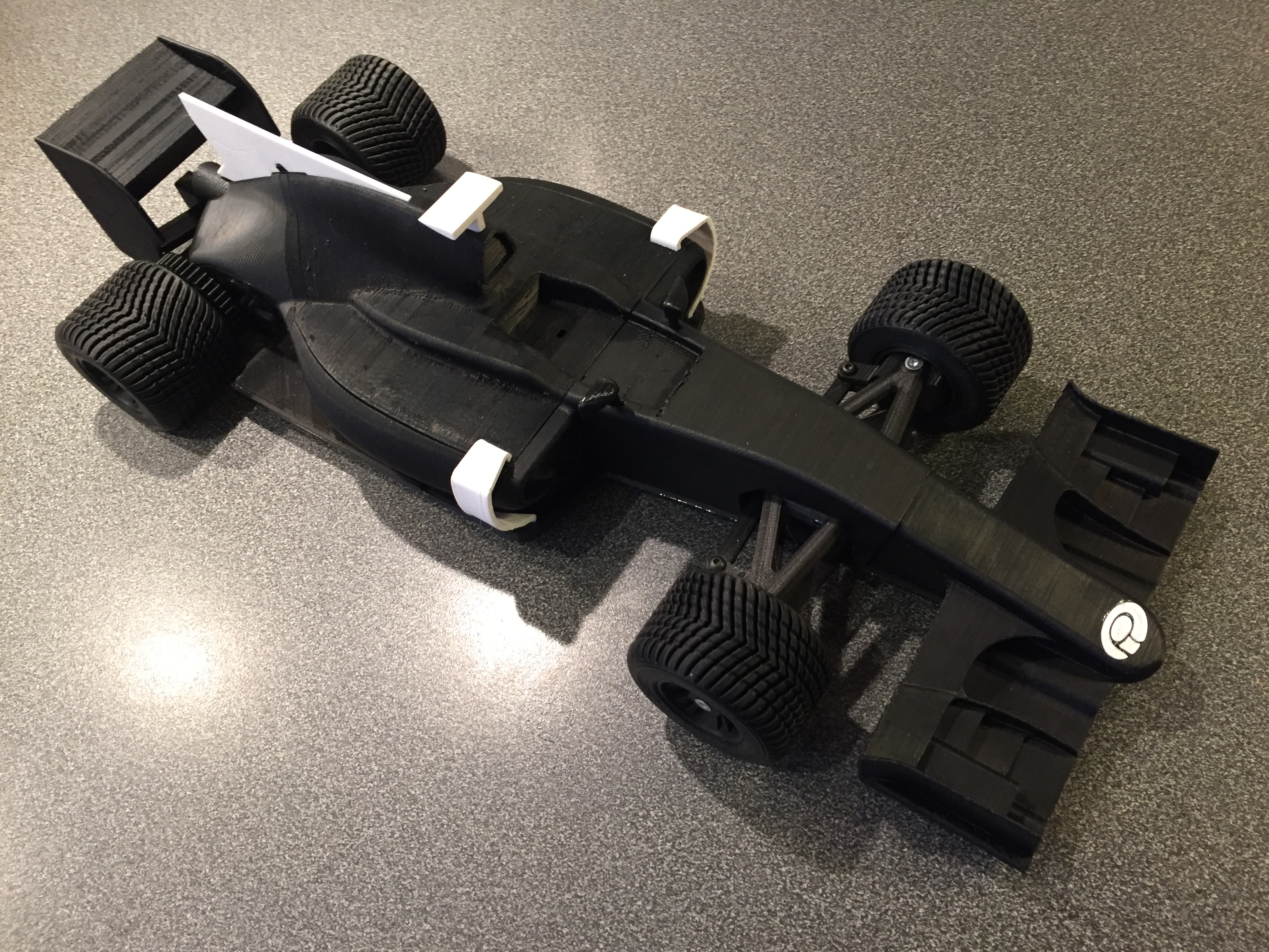

Crash-safe version? most parts printed in my special flexible filamaments. Emanuel Teljemo printed the flexible parts & Daniel Norée has printed the PLA parts, thanks!!! https://www.thingiverse.com/thing:1884110 https://www.thingiverse.com/thing:1968442 https://www.thingiverse.com/thing:2822107

What flexible filaments are you using, if I might ask?

And what temps do you normally run on the extruder and the bed? Do you need a direct drive extruder, like ninjaflex?
@Nate_T bowden is not optimal for flex… 220-230 deg. CT is shipping to US (no US reseller right now). Cold bed is ok or 50 deg C if preferred for thick/big parts
