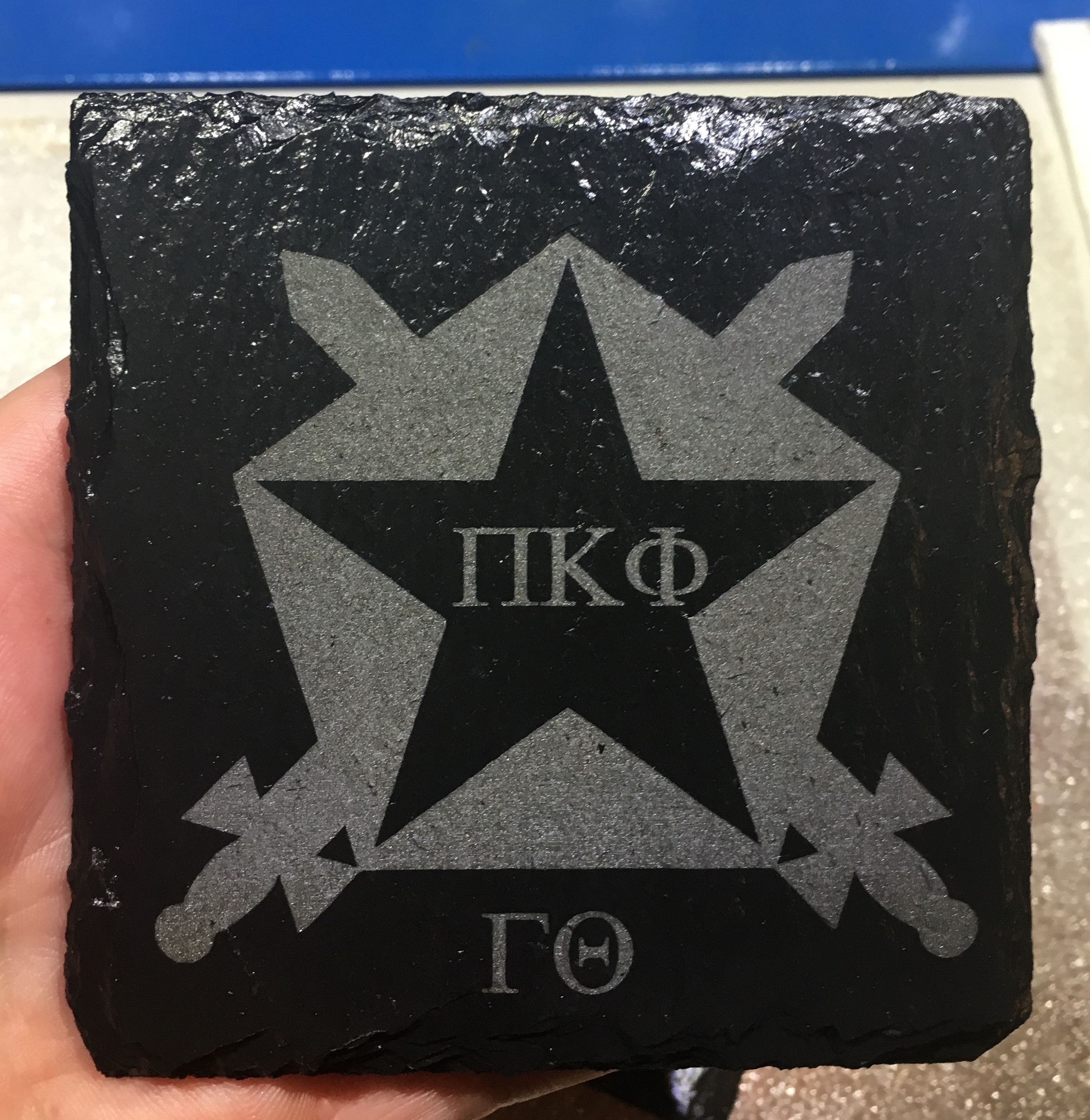

Created a set of custom engraved slate coasters with a custom 3mm ply holder. Made it for a silent auction at my up coming college fraternity chapter’s 50th anniversary get together.
Again very nice. Where did you get the slate from?
@Nedman what thickness material, speed, current, and lens did you use to make these cuts please. My engraving seems to be ok but not cutting that well and I need a reference.
@donkjr The slate came from Michaels craft store of all places. They are selling a set of 4 4x4" coasters, with thin bumper pads on the bottom, for $3.29. They had a 40% off storewide over thanksgiving weekend if you ordered online. So I ordered 30 sets, got free shipping, and cleaned them out online :). They seem to be back in stock online and local stores may still have some if there is one in your area. On Alibaba you can find them even cheaper if you are will to buy at least 100 sets and wait for the slow boat from china shipping.
https://www.michaels.com/slate-coasters-by-artminds/10212298.html
The thickness of the birch ply for the holder was 3.1mm. I cut it at 10mm/s and 5ma. (Keep in mind I’ve got a brand new tube) My lens is a 50.8mm focus that I got from light objects.
This was actually my first time doing slate. It was interesting that the actual engraving didn’t really depend much on the power and speed. That is, there wasn’t much difference between high power and slow speed and lower power/fast speeds. This is probably true to a certain extent as I didn’t try and find the bottom range of speed/power. It appears that the laser is just thermally altering the mineralogy of the slate and it’s just a surface effect.
Also noticed that I was sometimes seeing small black specks in the engraved area. When I looked them under the microscope it was clear that the specks were mineral inclusions in the slate that were resistant to lasering.
