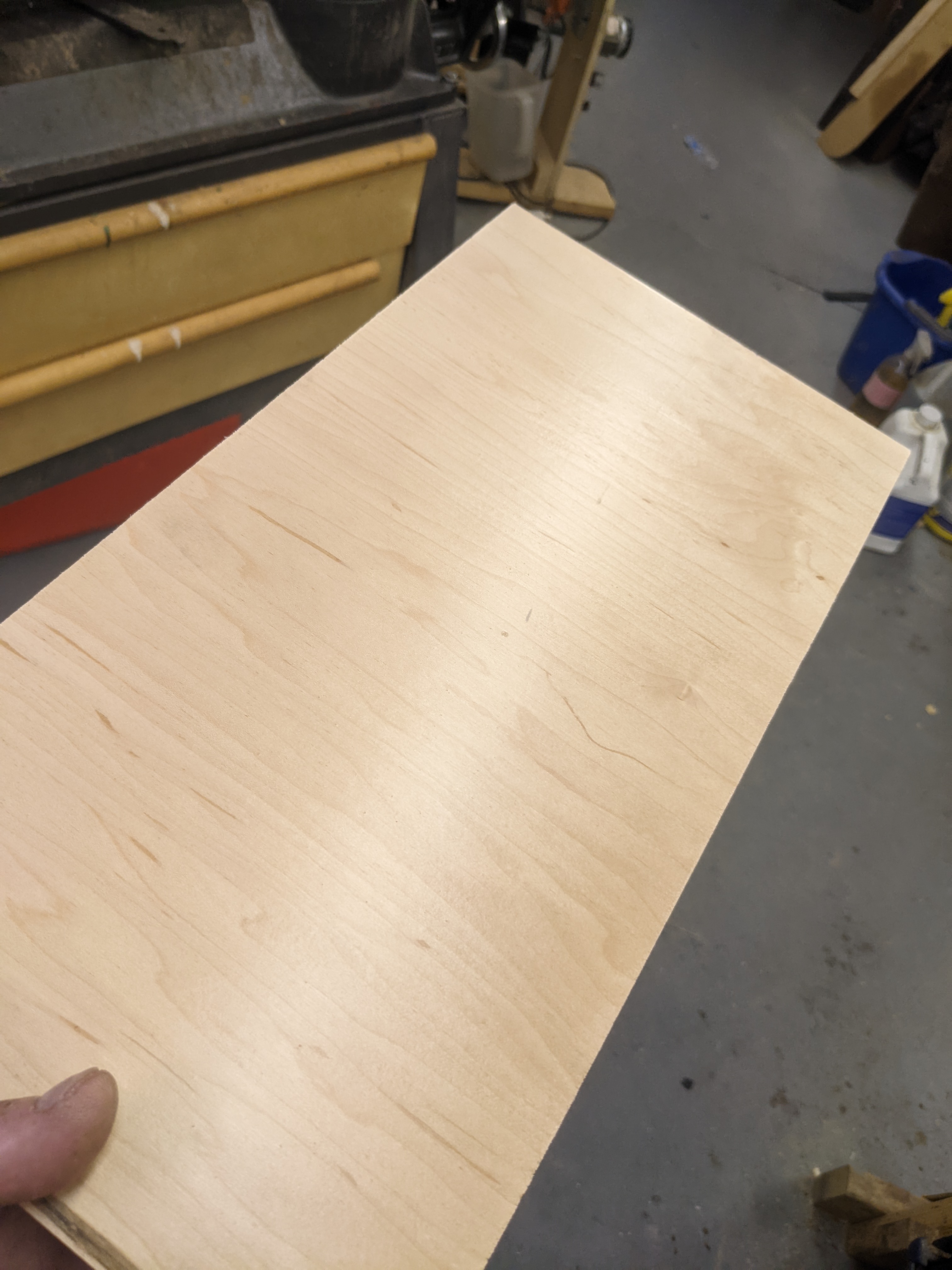

This is a piece of maple veneer plywood sprayed with Minwax water-born poly @30psi. The picture doesn’t do it justice. The surface after two coats had minimal orange peel and good coverage.
