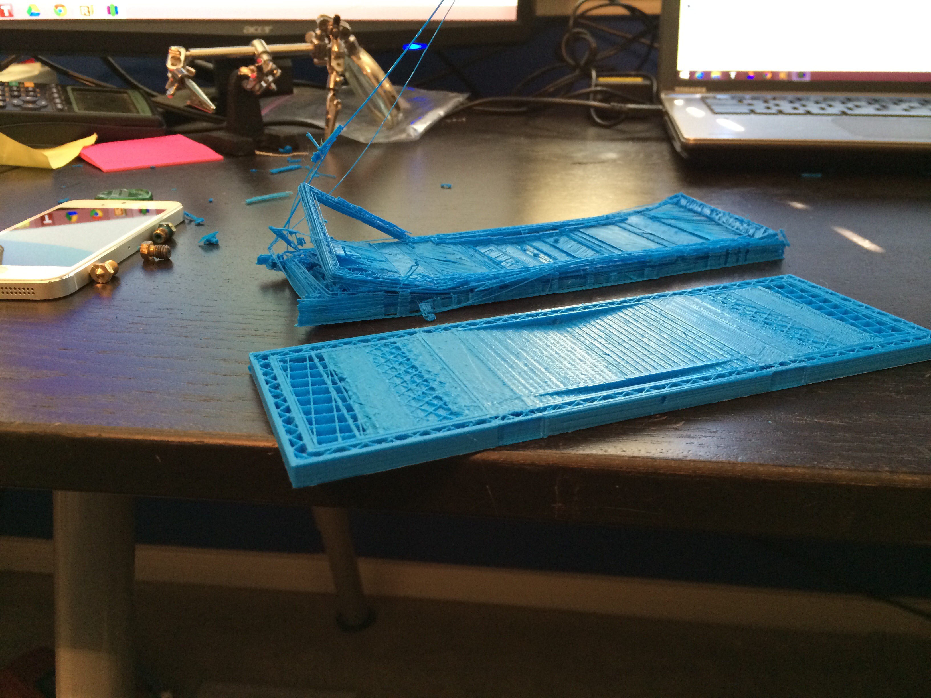

Cura(close)/ Slic3r 1.1.6 with pillar support (back).
Cura(close)/ Slic3r 1.1.6 with pillar support (back). Still facing nozzle jams, but real issue lies in the slice. S3d downloaded here’s hoping for a productive evening.
