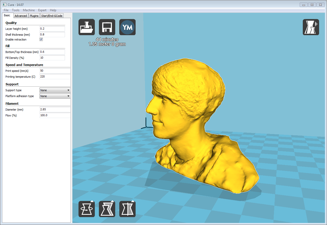

Some time ago I’ve seen somebody loading a mesh into #Cura. Then he was able to move the model in the z axis until he got a nice base for printing. Any suggestions how to (re)do that?
Thanks @Manuel_Meister for beeing the best son and lending your head for my project. :slight_smile:
http://www.123dapp.com/catch/2014-10-1-12-38-26/2842097
advanced -> quality -> cut off object bottom
Yes, that did the trick! Thank you very much :slight_smile:
