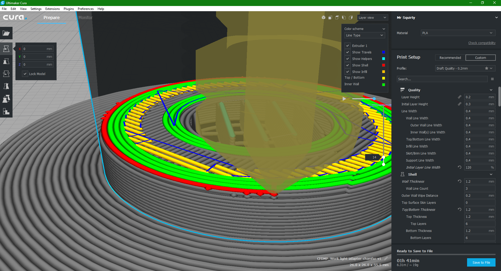

Can anyone tell me why this happens?? I’ve sliced this with various settings on wall/shell thickness , even different overall resolution. All with the same result.
It basically does weird bumpy stuff on a section of layers . if you look at the zoomed out view you can see the green of the inner wall showing through. there is nothing unusual on the inside of the print causing this as far as I can tell.
I even upgraded from an old version of cura to the latest.
I actually did the realtime Play version of the layers to see what it was doing and you can see in that screenshot it’s not a “starting a new layer” problem as it’s basically in the middle of printing the layer. It just does that outer wall a bit further in and then makes bumpy bits. The outside is a continuous steady angle. It’s fine at the bottom, does a few weird mm of layers and then goes back to smooth/normal/nice.
Have you made sure that your geometry is good? The STL file could have flipped faces, etc though Cura is typically pretty good at handling this and fixing it. I’d run it through netfabb and try slicing it again.
@ThantiK That might have done the trick!
