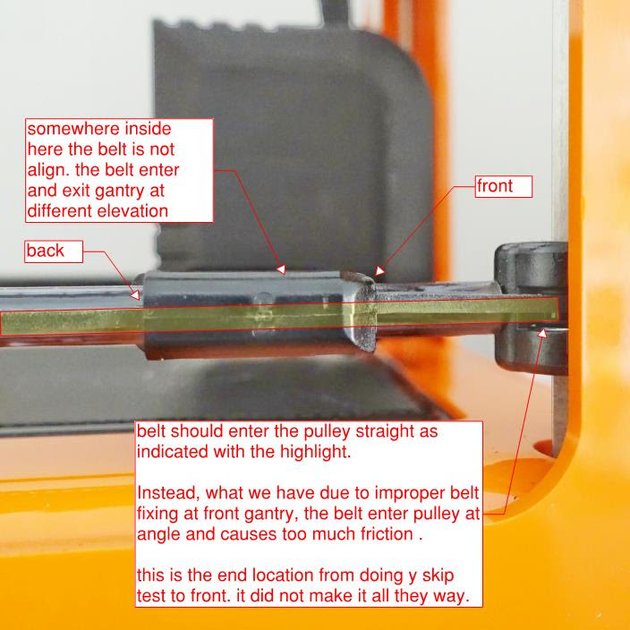

currently having a very frustrating issue with my printer.
#M3D currently having a very frustrating issue with my printer. it would consistently cause y-axis drifting. I think they installed the belt incorrectly
I looks like belt is attached inside that gantry - maybe it is not attached at level?
It does look like that is the case. Just waiting to hear from M3D support seems like they are very busy… I may need to tinker with it myself
Returned. Replaced with new printer. Works much better now
