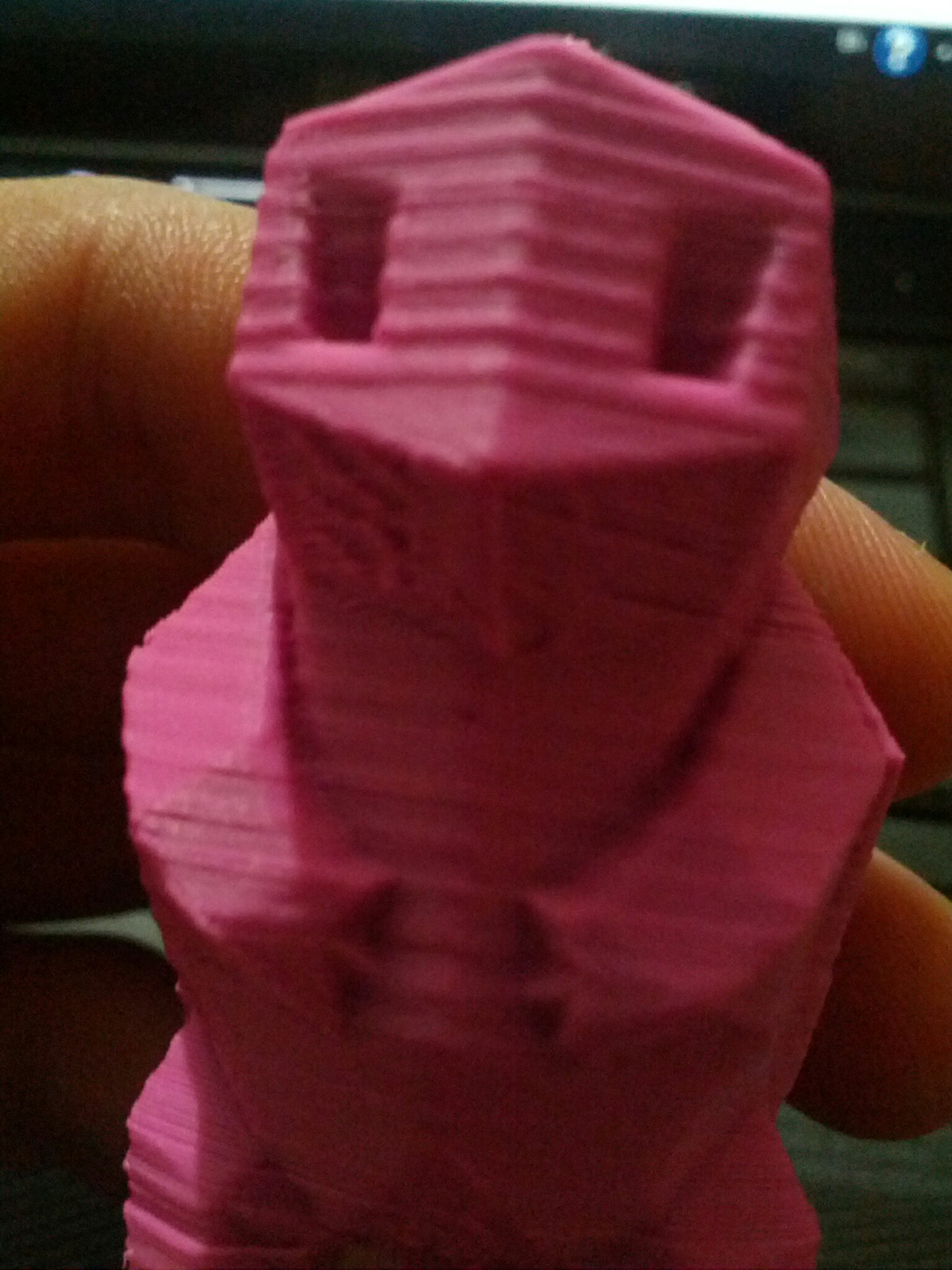

Currently I am testing my 3d printer and i want to know how to
Currently I am testing my 3d printer and i want to know how to improve the print quality specially removing those bold lines.
My slicer configuration is

Nozzle size? Printer type?
the lines on the face and back of head are equal distance so it points to a mechanical problem. wobble at the Z axis, loose belts, or wobble in the bearings.

but yes most def a mechanical issue.
It is a custom printer made by my friends and me … The nozzle is 0.25 mm
