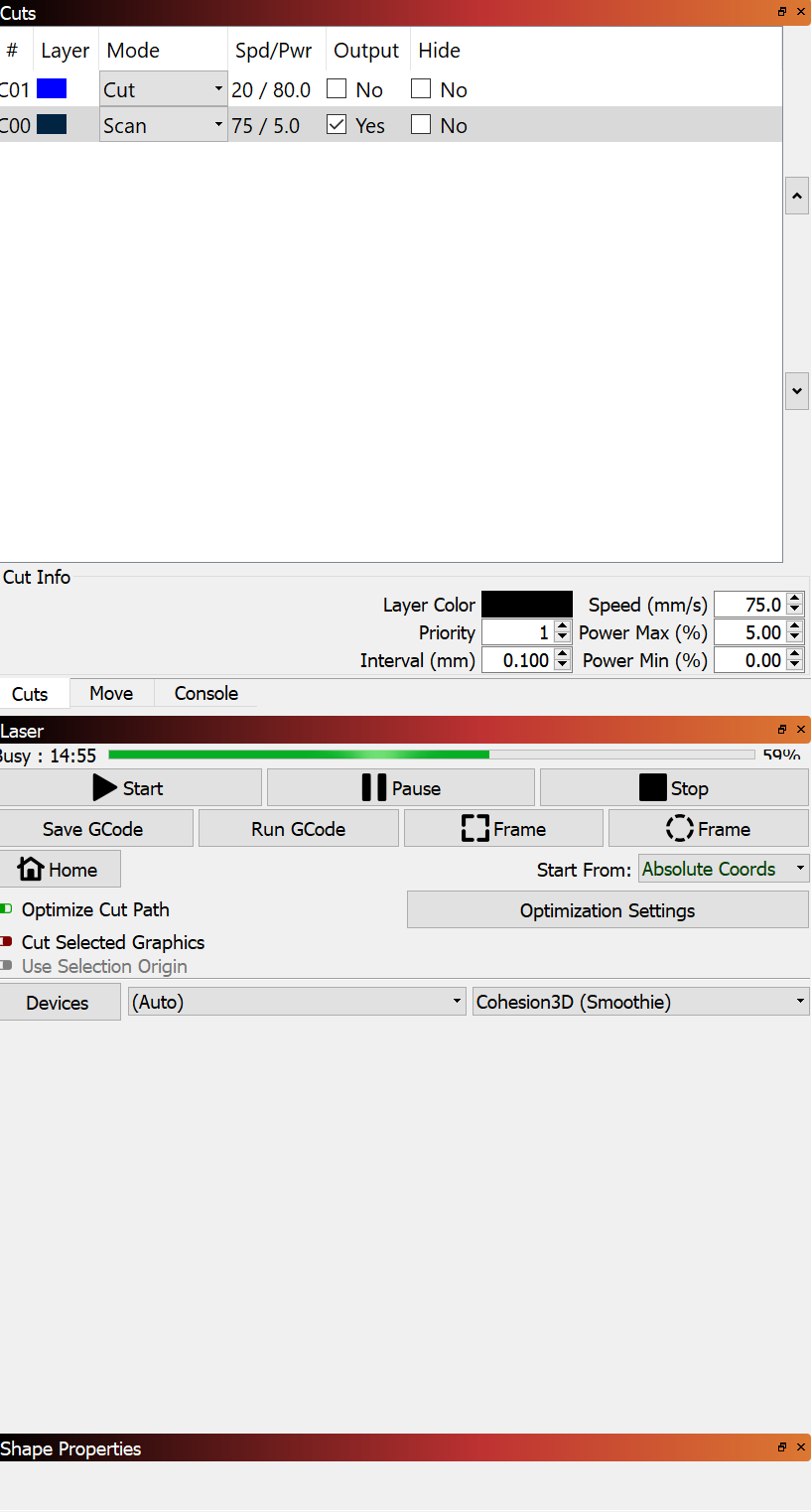

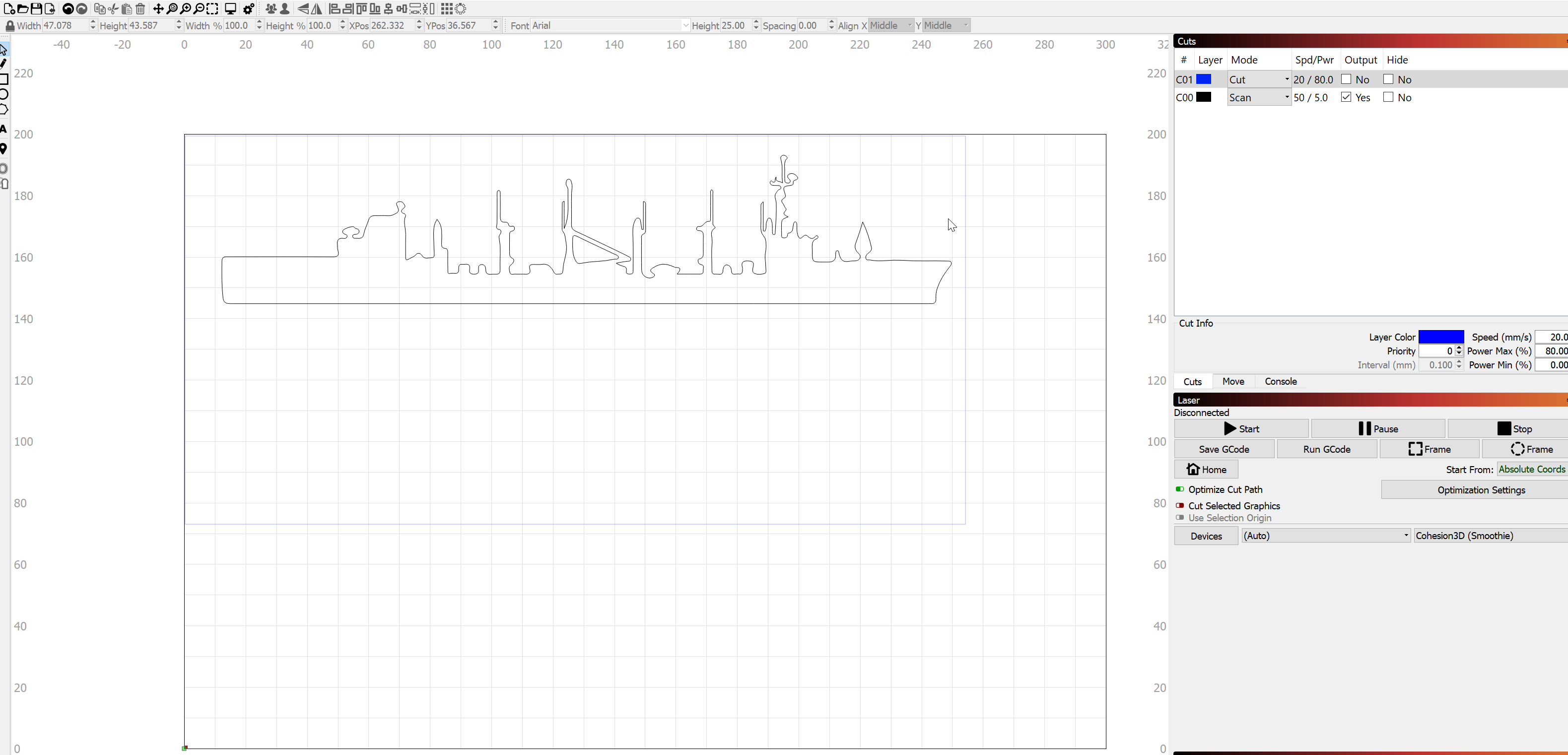

Only difference is where it shows the machine is disconnected the timer was still counting and the line indicating amount completer was about 50% across.
Tried again this morning it made it a little further. software shows busy but LCD display shows idle.
