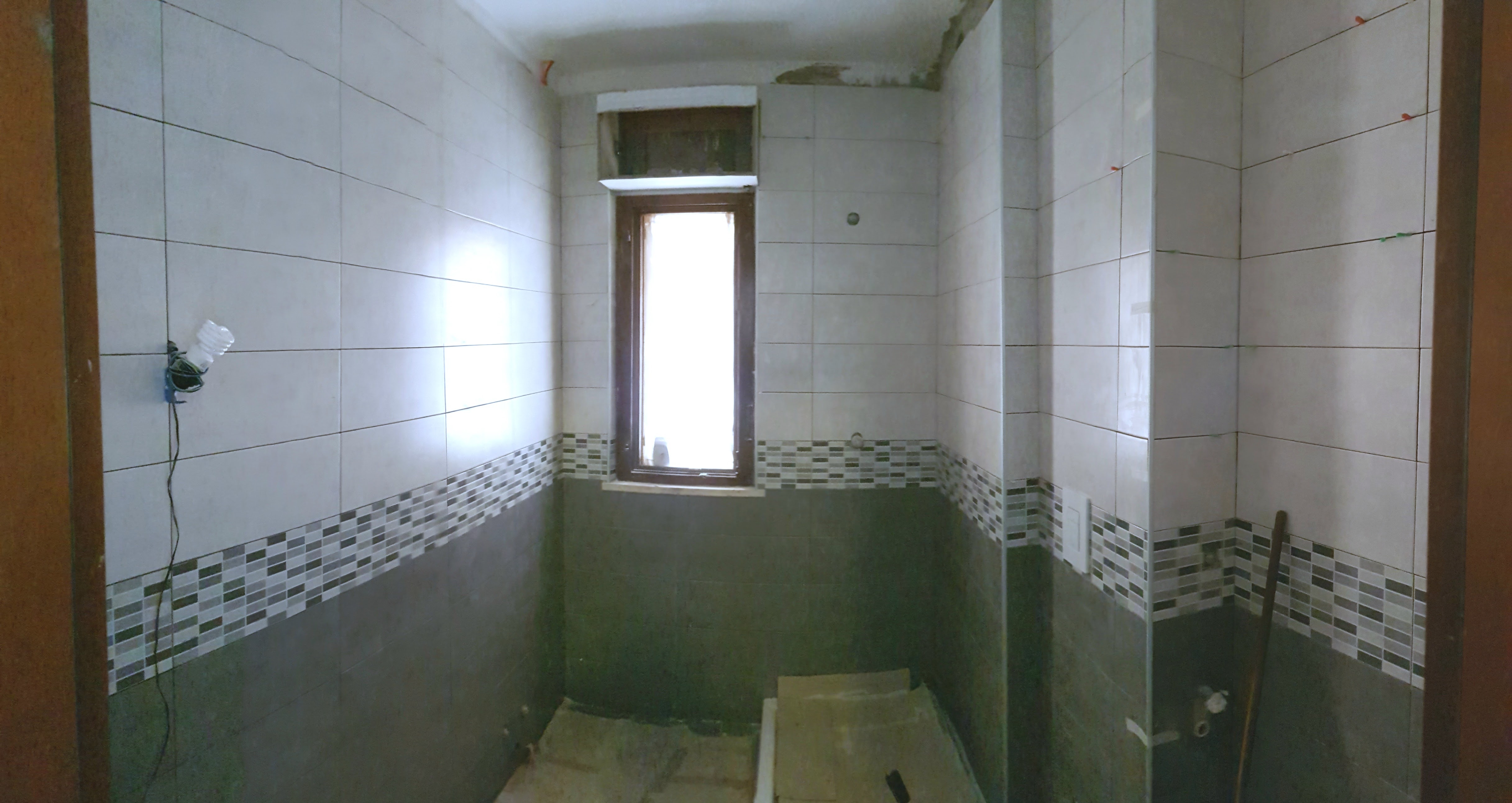

Custom angle ceiling for my bathroom ( product on market not cover my size and esigence)
Originally shared by Mauro Manco (Exilaus)
Before -during - finish, 3d printed custom size angle from #exxential king
How long did that take to print?
2kg of pla 0.5 layer 0.8nozzle 2.4h 500mm spiralize for a Total of 40hours use 3 day for print all
Beautiful work!! You did this? Great idea as well for the lay out of your bathroom. I would love to see pics of the bathroom before the ceiling was angled. Was the whole bathroom a renovation?
@Lindsey_Mohler for sample in first photo no notice because panorama photo curve photo anyway in top of left have 8.5cm title-roof In right angle have 9.8 (on back left 6m right 10) try to find standard photo where that more visible
No have photo before works anyway ceiling angle no visibile because lower titles, cover only half wall not as now , only when put titles for all wall. Red line in real are planar and in level, blu line can see softly increase from left to right.
