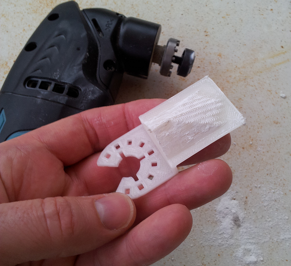

Here is a 3D printed custom attachment for my Makita multi-tool that I designed myself.
The attachment is designed to cut 90-degree V-grooves into the back of plasterboard sheets (also called drywall/rockwall/gyprock etc) so that the sheets can be bent to exactly 90 degrees without needing the typical metal edging.
Because the front of the plasterboard is never cut through, there is also no need to fill and sand to finish the corner. This attachment makes a perfect, sharp corner with a minimum of time and effort.
These photos show a small piece of 13mm plasterboard I cut and bent, just to prove the attachment actually works, and to test the finished quality of the corners.
Next I plan to make attachments for 45, 30 and 15 degrees so that I can form corners that are closer to smooth curves.

If there is a proper way to cut V-grooves in plasterboard with an oscillating multi-tool, or anything else, then I know nothing about it!
But then I am new to cutting plaster anyway, so this little attachment is only a very naive attempt.
I was actually pleasantly surprised that this attachment actually worked. For 3 hours of messing around with Sketchup plus my Printrbot, it’s a fair result.
Most of my time was spent sizing the adapter holes and getting them in exactly the right place so that it locked good and tight in the multi-tool head.
The rasp at the business end was pretty easy to draw and get right.
3D printers really rock - I would not even attempt to do this without one.

@Mark_MARKSE_Emery I am just as interested as you are!
For reference, this was printed at 0.3 mm layers.
Also, the multi-tool speed was set to the slowest speed. Any faster and a lot of the cardboard facing comes off as well. That isn’t too important since it’s the inside that gets messed up, but it seems to cut slower when that happens.
I am going to make some small changes to the design before the next cuts. I want to round off the front a bit so that it rides over the cardboard facing much easier.
I will make a new post here when I have done that.

@Joe_Spanier
After I make some adjustments to the design and test a new cutter I plan to post details on Instructables to describe the cutting process.
Just briefly:
I slice away most of the cardboard above the V-groove with a knife prior to the actual cut.
Then I cut by making several passes to deepen the groove with the nose of the attachment touching the groove but the back raised. (It can’t cut the groove in a single pass.)
The non-cutting part of the attachment needs to be re-designed with a rounded, bull-nose front to stop it gathering the cardboard beside the groove on each pass.
