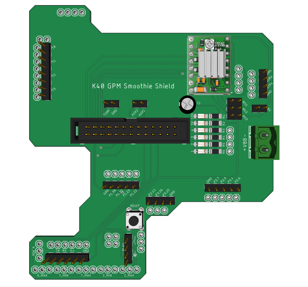

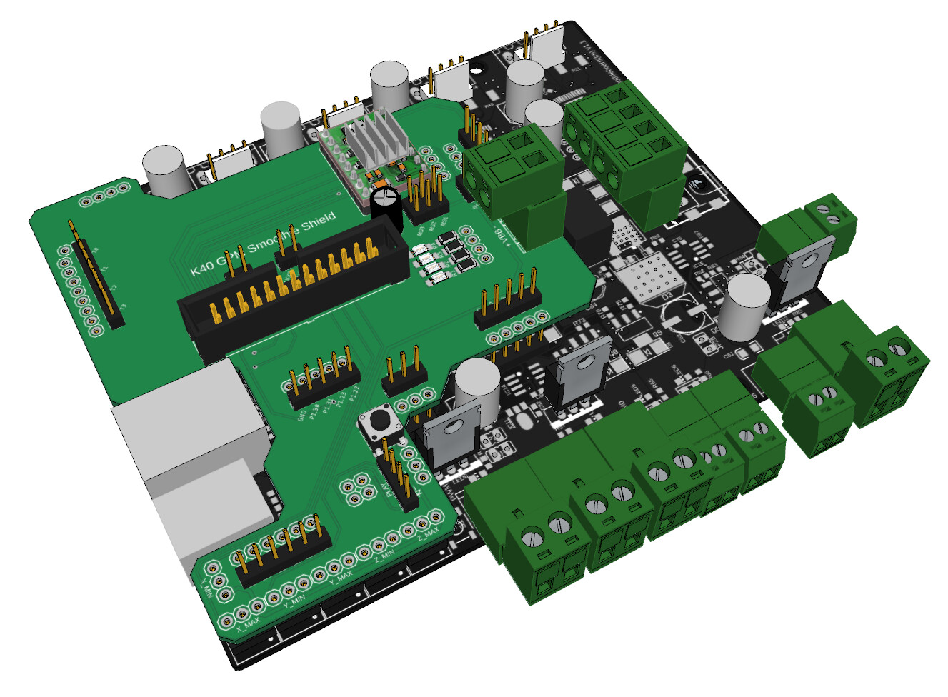

Here is a 3d model of the shield in place on the Smoothieboard…
and here is the schematic/pcb layout
I have passed through a bunch of pins for me to use for switches, plus the serial connection as I plan to add some form of control panel in the future.
So can anyone see any glaring errors or have any suggestions/feedback. I am not an expert in PCB design or electronics, and as we all know sometimes a little knowledge is dangerous :blush:
Aside from that can the thermistor pins & unused motor pins be used for input for the switch module?.

Those look like the right basics for things that connect to the smoothie
Other things you might consider the control and wiring for:
  • Air assist & control
  • Cover interlocks (particularly annoying to wire if you do not have a PCB)
  • LED pointer
  • Evacuation fan & control
  • Coolant temp
  • Coolant flow

Whoops, a major mistake with the shield PCB, somehow I managed to mirror the A4988 carrier board. :blush:
Good job I spotted it, time for a bit of redesigning then. :roll_eyes:
Ok, so clearly I shouldn’t work on something early in the morning until I have had at least 4 cups of coffee. :coffee: :coffee: :coffee: :coffee: I am not sure why I thought the A4988 was mirrored. :man_shrugging:
Anyway, I have been finalizing the design of the shield and it occurred to me that as the shield is covering LEDS 1-4, that I should perhaps bring them through to the shield using jp29…
@Arthur_Wolf Is it ok to drive 2 sets of LEDs? (using 1k resistors)
Yes it should be fine, there’s nothing special about them.

I think I am just about ready to order the PCB’s now. The main changes from the initial version of the shield are…
  • Added the connector for the temperature feed down to the head. (which I initially forgot!)
  • Added a spare 5v header.
  • Added the 4 smoothieboard LEDs + one for 5v and 12v (VBB).
  • Added a ground pin for JP20.
  • Added a pass through connector for JP15.
  • Cut down the 12v and GND lines on the ribbon connector to 4 lines each and brought out the 2 spare pins as aux connectors. (For some reason I originally though the 12v lines would be supplying the motors as well, but as they are just supplying the laser module or possibly spindle, 4 lines should be sufficient)
Also, to answer my own question in the first post, I did some testing today and I was able to use the thermistor pins for the switch module. As these inputs are pulled high by RN1, I just inverted the pin and then connected a switch between the thermistor pin and AGND.
I am really hoping that I haven’t missed or forgotten something.

I started using Eagle back when it was Cadsoft at v5. I didn’t use it for a few years, until last year and was surprised to find Autodesk had taken it over and glad they still offered a free version. I was going to try and learn Fusion 360, but I am getting too old to learn new tricks and I just love using Sketchup. I also love the awesome EagleUp plugin, which is what I used to make the 3d models above. It really helps to confirm component layout and spacing, as well as making it simple to design mounts or brackets for the PCBs.
Anyway the K40 GPM PCB’s have been ordered from China and allegedly, are already in production. :smiley: I just need to order a few components and prep the Smoothieboard. I am guessing it makes more sense to put the male connectors on the Shield and the female on the Smoothieboard, but I suppose it really doesn’t matter either way.
Impressive service from jlcpcb, I ordered the PCBs last Sunday and they arrived today! I haven’t inspected them properly yet, but the shield looks like it fits nicely around the USB/Ethernet, which was my main concern. I have all the components required, so I will try and get one assembled tomorrow, if it’s not too cold out in the workshop.
You don’t need a VBB connector on top, there’s a VBB pin between M2 and M3, which will handle enough current for a stepper driver
