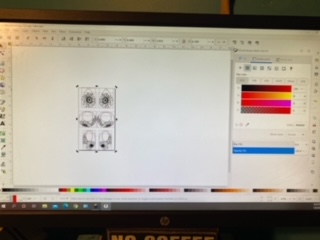

sunflower earrings 1
Here is the file. I had to ask the person I bought it from if it was ok upload to this forum. Thank you
I just bought another file from the same person and it worked just fine.
It’s the wrong red. It’s #ed252b instead of #ff0000.
The reason why you couldn’t see that is because those paths are clones (they are <use> elements).
If the original object has a stroke color set, you can set the stroke color for the clone to something else (and you’ll see that value in the Fill and Stroke dialog), but it won’t actually have an effect. The stroke color from the original will override the stroke color of the clone.
(The style of a clone will only have an effect if that particular style was not set by the original.)
Here’s one way to fix it:
  1. Select all (Ctrl + A), then repeatedly use ungroup all (Ctrl + Shift + G) until the status bar reads:
    No groups to ungroup in the selection.
  2. Hold Shift and click on the red paths one by one to select them. If you accidentally click on the wrong object, just click it again (without letting go of Shift) to remove it from the selection. Once you’re done with selecting them all the status bar should read:
    12 objects selected of type Clone in root. […]
  3. Use Edit → Clone → Unlink Clone (Shift + Alt + D). Now you have regular paths in your selection.
  4. Set the stroke color to red (#ff0000) in the Fill and Stroke dialog.
odd since it shows up as ff,00,00 when I open it.
I got it to work using Inkscape by first ungrouping then copying the design to a new file, then I had to select a red one outline, convert object to path, then in stroke/fill I had to exercise all settings, toggle fill on/off, toggle stroke gradient/flat, set the stock width to .5mm. Notice if the toggle changes the outline and if it does you know you’re effecting the line and it should set the properties correctly.
ugh, a tough one.
Yes, the stroke color for the clone is #ff0000, but the original path (invisible, stored in <defs>) has the stroke color set to #ed252b. Since the original has some stroke color, the stroke color of the clone won’t be actually used.
