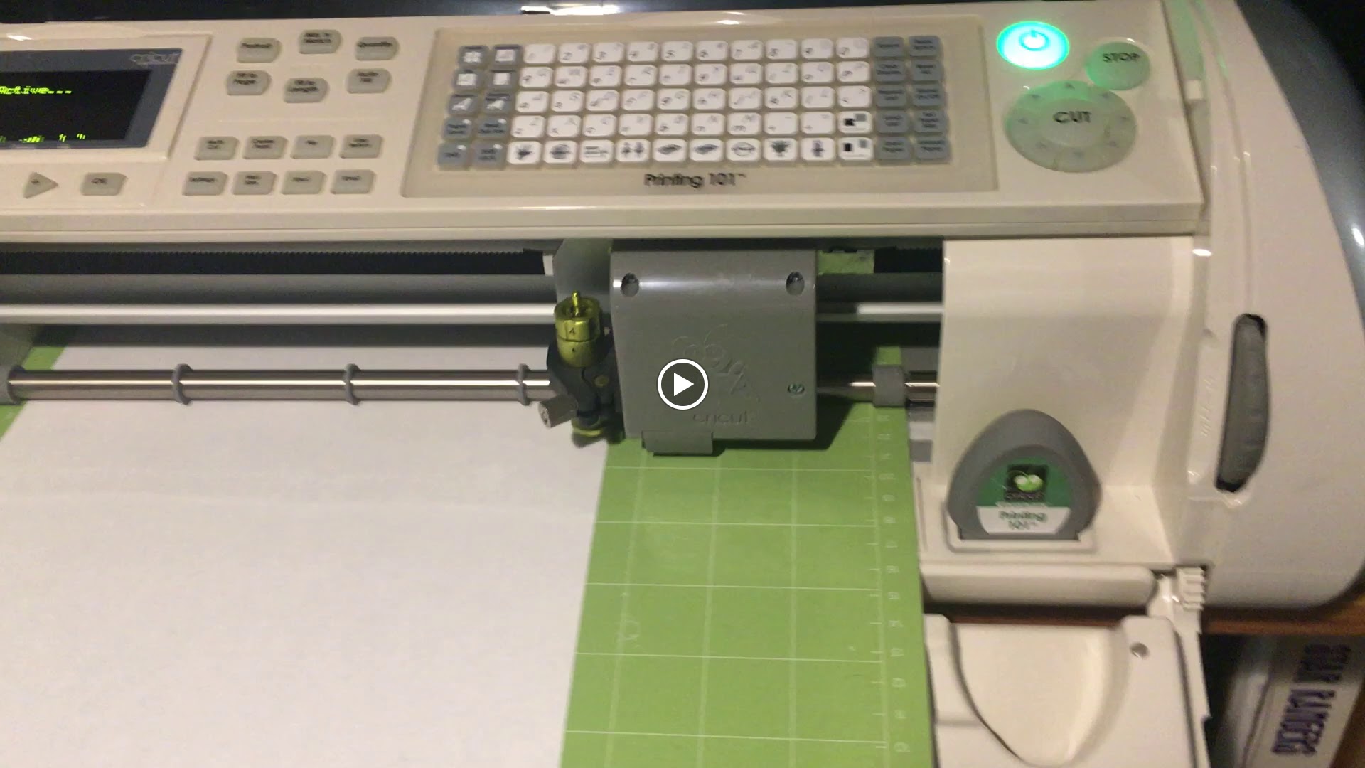

Cutting a new vat (template) for my Morpheus Delta printer on my wife’s cricut machine.
Nice
It worked just,as well with the vat film, I figured it was easier to see using paper.
How are you able to cut custom templates with your cricut?
I created the drawing in fusion 360, then exported to pdf, converted it into svg, and used “make the cut” software (had an older version)
Which version do you have? I’ve been using SCAL 2.0 but it’s really buggy.
4.1.0 Which is the version right before they dropped cricut support, you can find it with a google search, and the plug in dll for the cricut.
