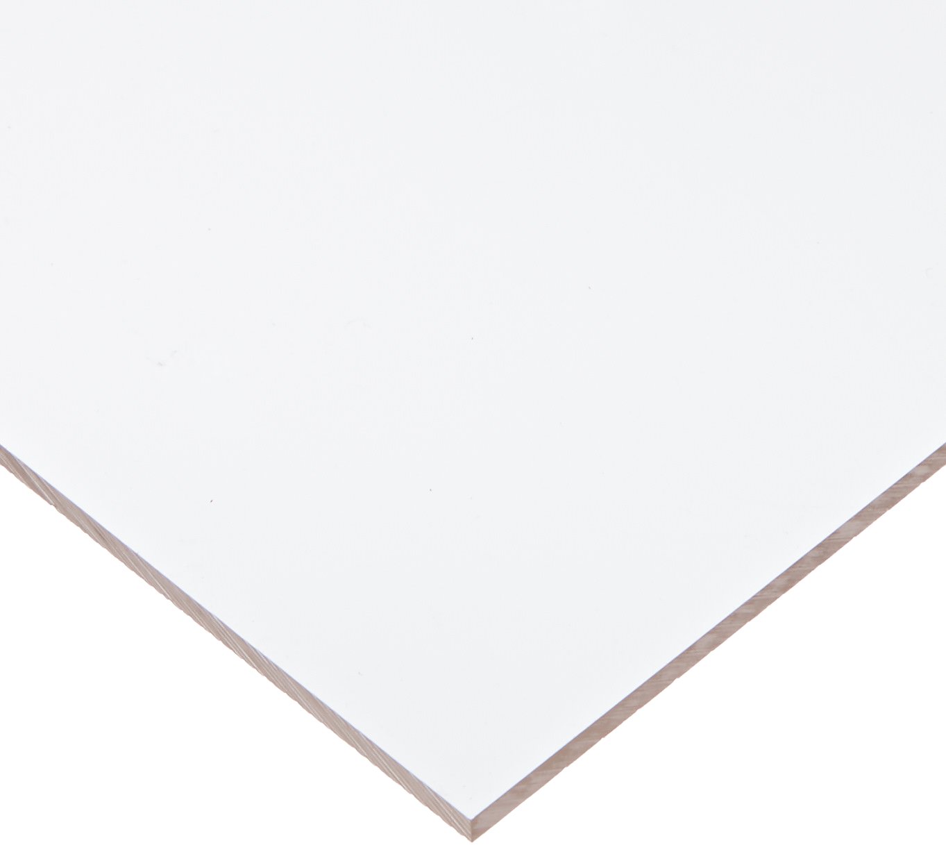

I am sourcing my acrylic from multiple eBay sellers. I don’t have any info to dispute it being acrylic, nor can I prove it is. I don’t see black smoke or soot. I see fine wisps of white smoke. Maybe my version of a bad odor would pale in comparison to plexiglass burning. I have no reference.
Is there a way to verify the acrylic I have purchased is acrylic?
Not really… sometimes on the plastic/paper backing it will say what it is, but not always.
Wait I thought plexiglas is acrylic according to Wikipedia. Polycarbonate also know as lexan is what I was told not to cut on the laser.
Plexiglass is a brand name, they probably make both. Lexan is also a brand name, and may also make both.
The stuff I bought is labeled “Plexiglas Acrylic”. I assume it is safe to cut.

Acrylic
The acrylic was sold to me by the seller of the laser machine. I don’t know if it’s real acrylic.
My home hardware (Home Depot) sell acrylic. I bough some transparent (4.5 mm 24 X 36 inches) 20 $ I didn’t try to cut it yet but I will tell you soon if it smell as bad as the acrylic I received with the machine.
