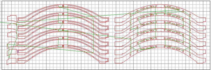

Problem description

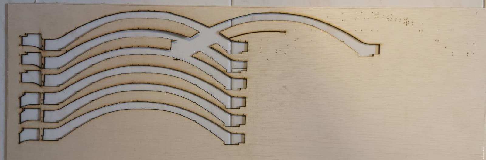

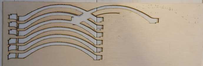

When I run the attached GCODE, a repeatable error occurs - the machine sems to lose steps on the x-axis and so a part is shifted to the left.The preview of the part in LaserWeb:
And this is how it turned out:
An arch was shifted to the left. However, I was in the room throughout the job and didn’t hear the stepper motors struggling or skipping steps. Hence it seems to me to be a software issue. Unfortunately after aborting the job, I didn’t take note of the displayed position of the laser head.

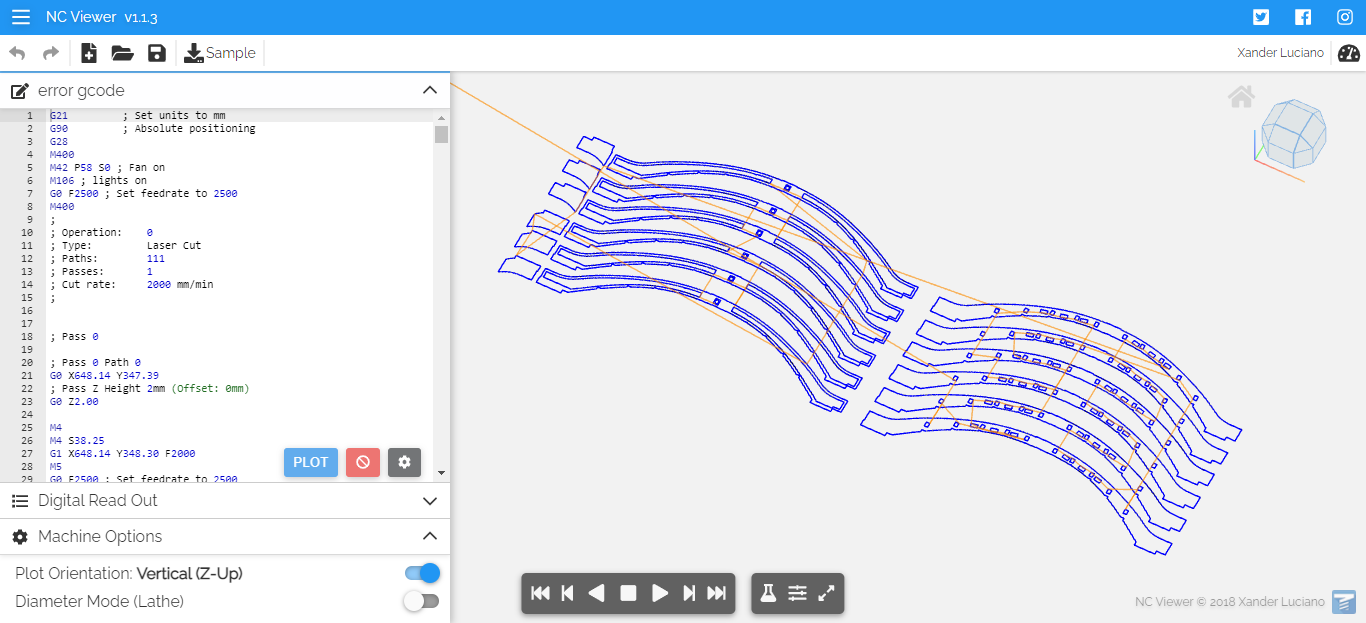

I have attached the GCODE below but it seems fine since NC Viewer displays the job correctly:
GCODE file: here

I’ve tried rebooting the Raspberry Pi as well as the frontend of LaserWeb. Next, I’ll try re-generating the GCODE after re-ordering the cut paths and if that fails I’ll disable motion and try again. However, I was hoping for a more long-term fix to this. My prime suspect is Motion as I’ve heard it’s resource heavy on the Pi.
Has anyone experienced similar problems before? Would be most appreciative of any advice!

LaserWeb should just be faithfully passing on the generated Gcode via the Pi and into your Ramps/Marlin controller. I’d be very surprised if anything was being skipped there. If the Pi is overloading you might see stops and stutters, but not a wholesale displacement on the x axis like that.
The most likely candidate is the controller missing steps during high-speed X moves, Try lowering the default travel (G0) speed in your controller config.

It seems that after re-arranging the cut paths and re-generating the GCODE, the problem went away. Have been running a bunch of jobs non-stop for a while and it seems to be gone for good.
@easytarget thanks for the suggestion! Will try reducing the feedrate if the issue crops up again.
