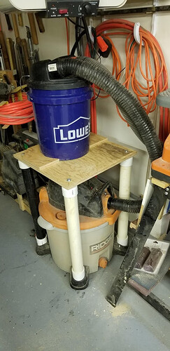

I do a lot of wood turning and typically sweep up the BIG stuff followed by vacuuming. This keeps me from overloading the filter in the shop vac with large chips.
I decided to add a cyclone separator to my system.
This build turned out easy to do and pretty inexpensive using a:
Info on the build here: Shop Vac + Cyclone Station

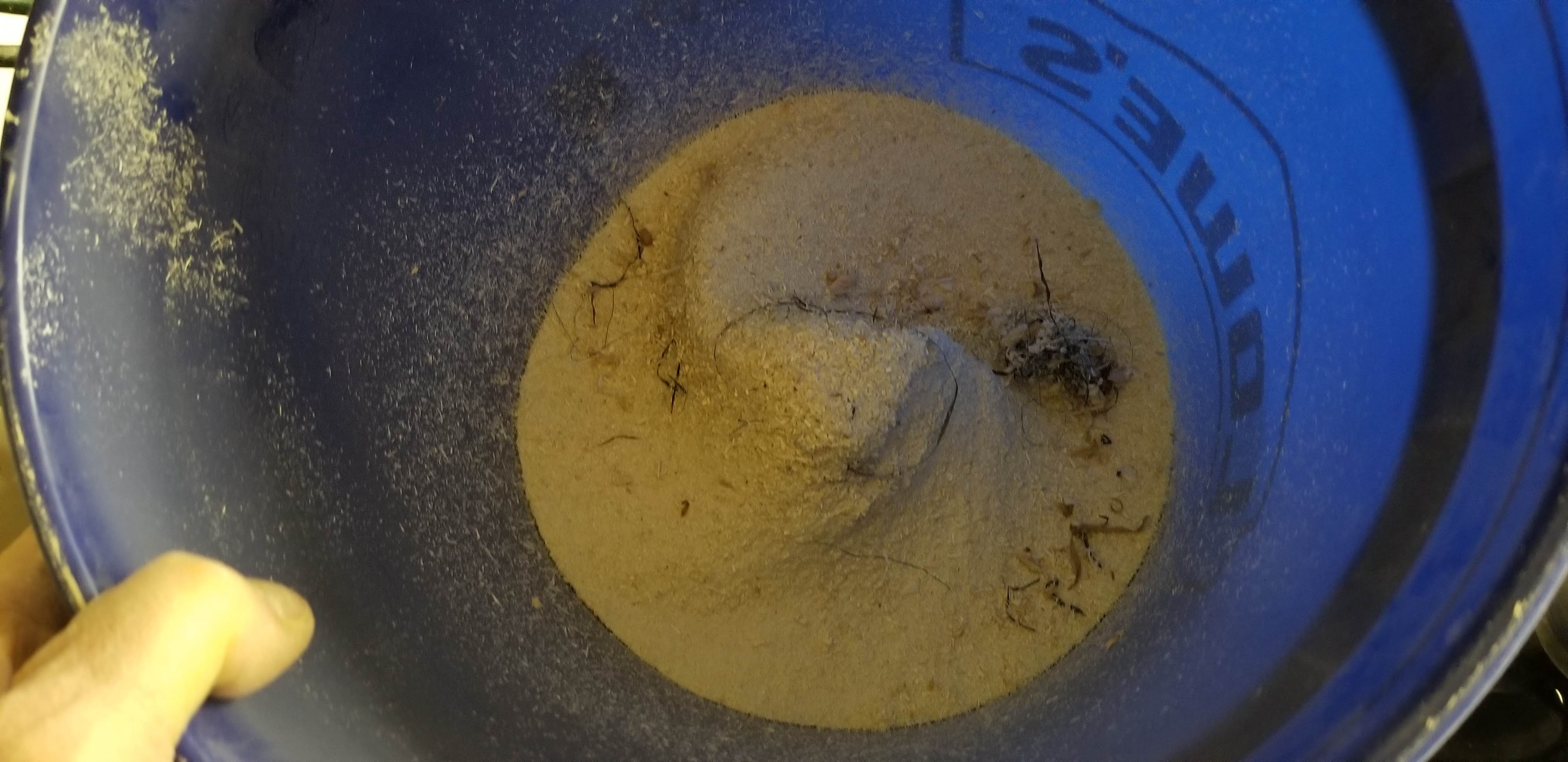

I built one of these several years ago using nothing more than 2 buckets, a 2 and a 5 gallon one. You attach the bottom of the 2 gallon bucket to the inside center of the lid of the 5-gallon one, drill a hole through the lid and the bottom of the 2-gallon bucket for your vacuum to attach to(I used PVC for the connection), and then one hole in the side of the 5 gallon bucket about 2 inches from the top of the bucket, that hole will be for attaching to your CNC or whatever. When I tested it, I used about a pound of sawdust and got less than a teaspoon of it in the vacuum cleaner’s chamber.
I have one that I built like you suggested and it works fine.
I needed another and this one took almost no effort to build and only cost $12.00 :slight_smile:
