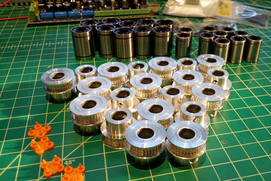

@D_Rob , and all others responsible, Thanks. I ordered the 32 tooth 10mm pulleys from robotdigg 5 days ago, and I have them already
It was thanks to him that they even started stocking them in the first place! @D_Rob thank you!
Do they have 32 tooth 5 mm bores or are you using a different tooth count on the motor
It was obvious we needed them and I saw they made custom pulleys. We did it together. I didn’t have a need big enough by myself. Couldn’t have done it alone
@Joe_Spanier they said they would make them when I asked… But I didn’t need qty: 50
Jason is using the standard 20 tooth on his with no speed issues. I went with 30 tooth from openbuilds. Turns out that was a poor decision due to non integer steps on z.
What did you end up going with @Eclsnowman I didn’t see them in the bom
@Joe_Spanier sorry I edited my first comment, must have been while you were typing. see above.
