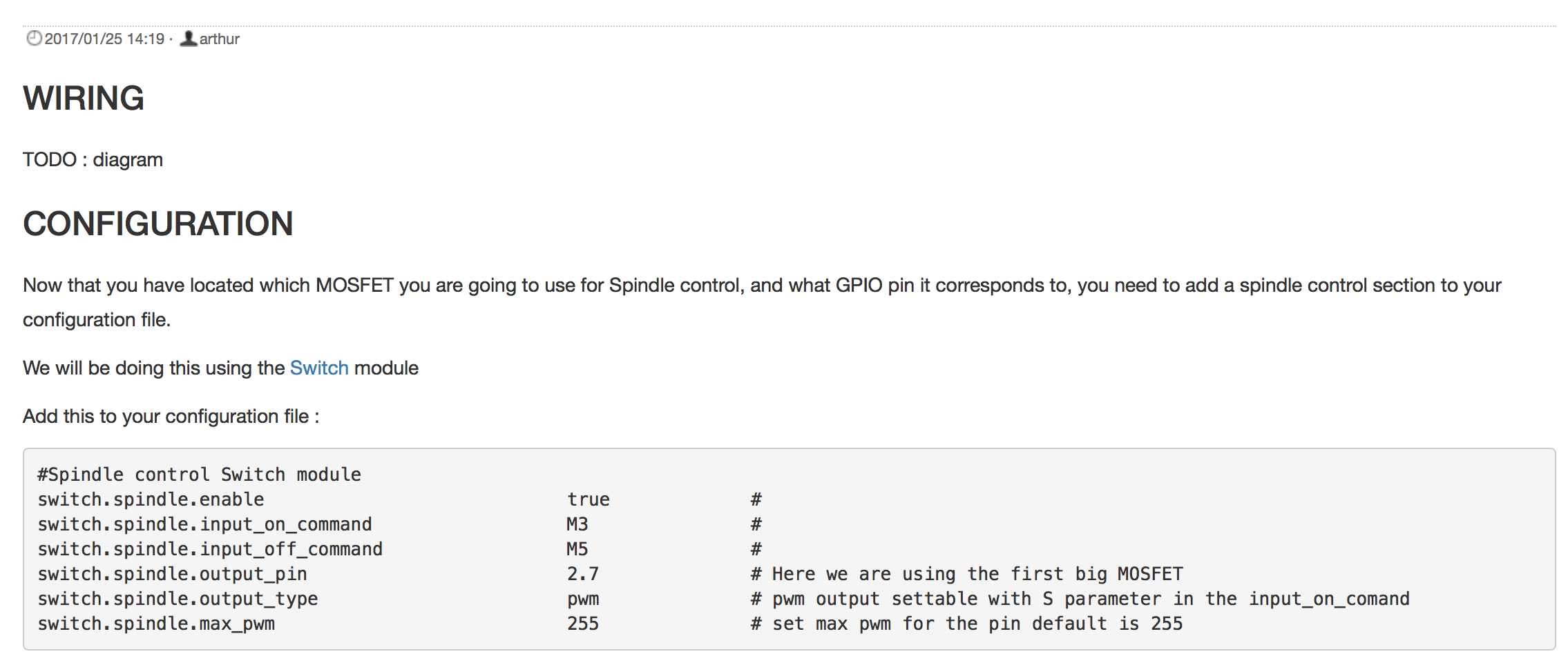

Can anyone relate the information in this part of the documentation taken from the spindle module to this part of the documentation taken from spindle mosfet control
with a wiring diagram?
