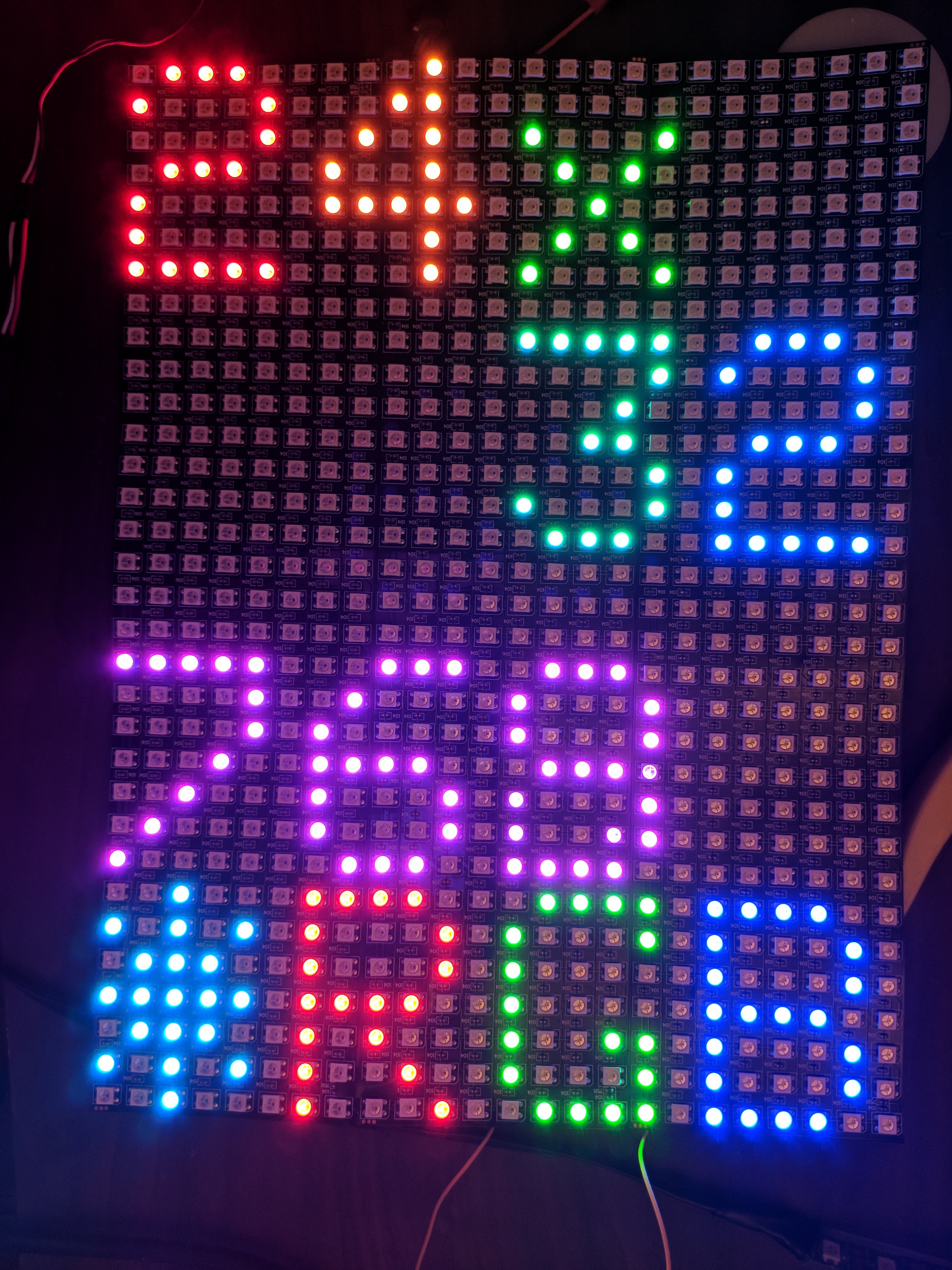

I’ll attach a few pictures to illustrate.
First one shows a counter running (purple on line #3) with no issues or glitches when all the panels are serialized.
Second picture shows how the counter gets corrupted once I hit the 2nd panel (they are 32x8) because clear does not clear, so stuff gets printed on top of one another.
Third picture shows the random corruption I’m currently fighting and that does not seem to be a bug in the library but an electrical problem since I’m virtually certain that my body position over the panels and wires actually makes the problem worse, or go away. Interestingly the corruption is either random garbage or sometimes the color components of a font are offset, like ‘32’ in the picture.

Now, I still get corruption when I receive an IR code due to that interrupt code, but it’s more manageable, and separately from finding a workaround in FastLED parallel output, I was really keen on finding a way to disable uncontrolled interrupts from the chip’s background tasks.
