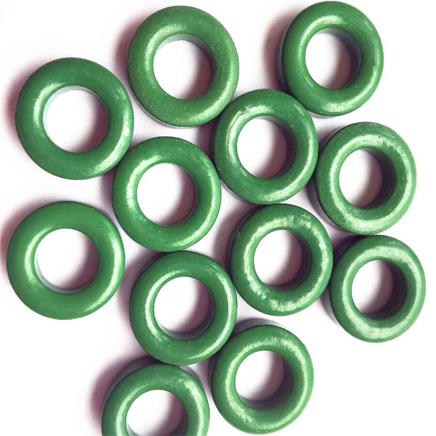

In the meantime, I solved my problem with corruption of secondary panels with parallel output. I naively used a servo cable with 3 wires to send all 3 data signals to my 3 panels, and sure enough, unless I turned the wires and touched things the right way, panel 2 often got corruption, and panel 3 even more.
I could definitely tell it was an electrical problem, and in this case an EMF problem.
I thought about it just a bit more and figured that the code would send a pulse on data line #1, then #2, and then #3. Sure enough, the pulse from #1 would bleed onto 2 and 3, and the one from 2 would bleed on 3.
The best way to handle this is likely to just send all 3 signals over 3 different wires, ideally even twisted pair with the other twisted wire being a copy of ground.
In my case, however, I was able to just fix it by adding a ferrite core and wrapping my cable with all 3 wires and signals around it
Ah, good discovery and solution.
(Your photo seems to have gone missing though.)
Trying again: here’s what it looks like
See it now. Simple. Glad that worked.

That’s not a bad approach with the ferrite cores and may keep that as an option for future setups.
