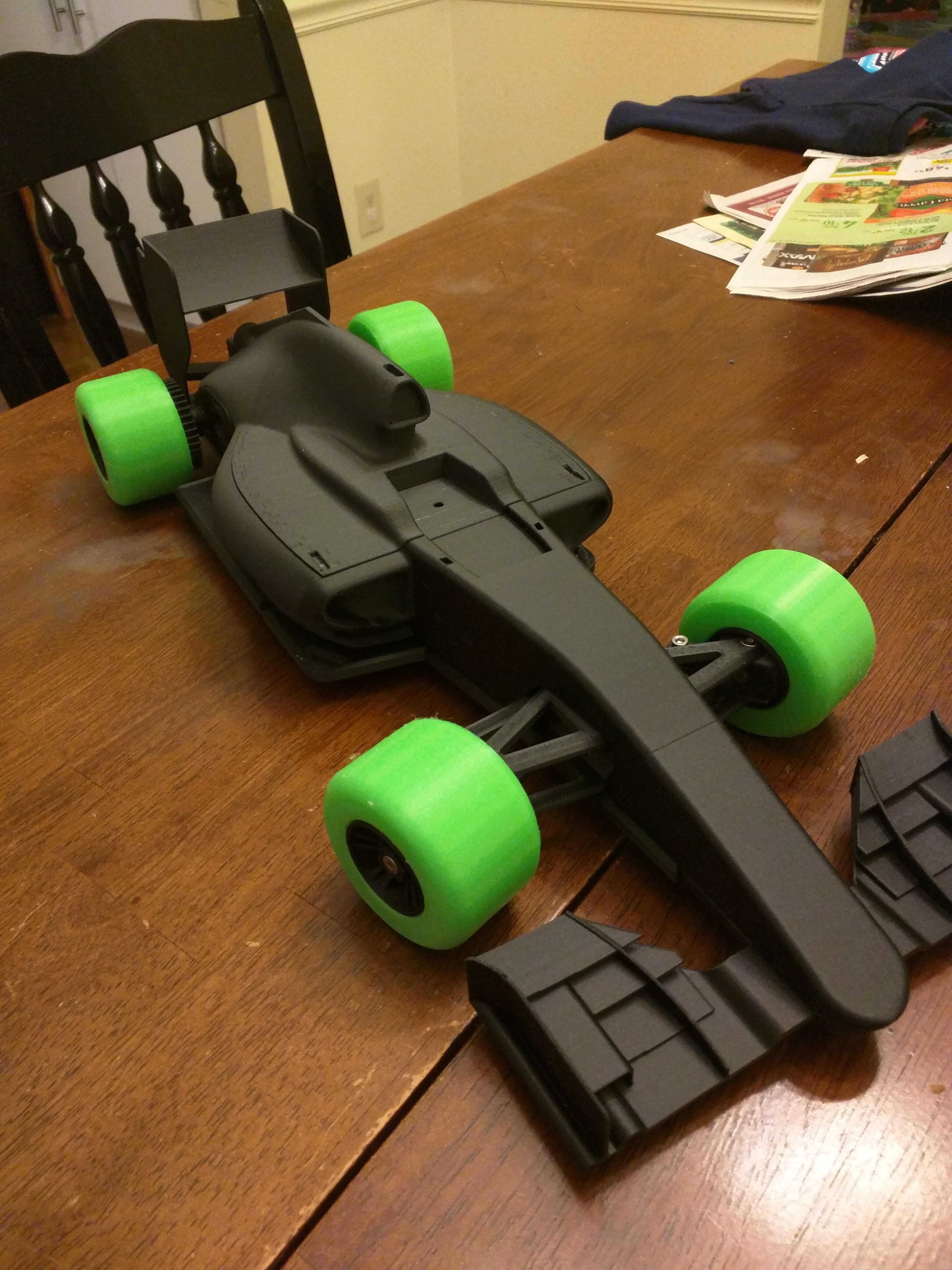

@Daniel_Noree Just a few more screws to go. Test fit assembly looks awesome! Still need to purchase electronics. Still amazed at Robo3d CF!
Wow, that look incredibly smooth!
very nice and clean print. Well done!
@Mark_Ellison Printed on Wanhao Duplicator i3. I had a gift card to Best Buy, they carry Robo3D filament. Stumbled across CF and had to try it out.
@Mark_Ellison In order to use Carbon Fiber, an all metal hot end is desirable. If not, you’ll be changing tips several time per spool. Micro Swiss has a kit to upgrade the hot end. I’m also using a 3rd party extruder, which I’m not able to divulge yet since its still being developed.
