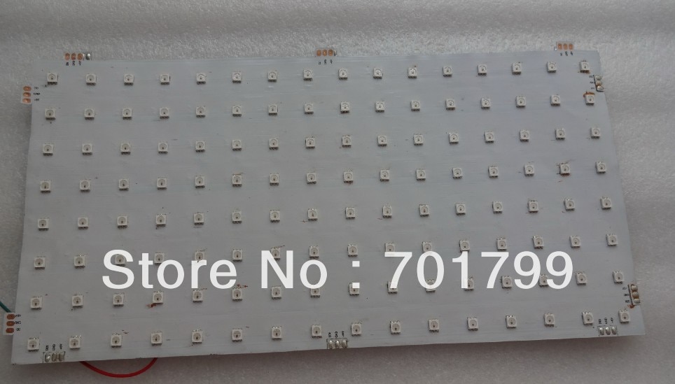

Data point. These 8 x 16 pixel panels: http://www.aliexpress.com/store/product/P20mm-WS2812-LED-digital-flexible-panel-light-8-16pixels-size-16cm-32cm-DC5V-input/701799_1085573230.html ...
… pull about 2.25A @ 5V on full-white according to my multimeter. Which is about 18mA per RGB LED which is a lot less than I thought they would. Aren’t they meant to be 20mA per R, G and B, i.e., 60mA per WS2812B?

I’ve done some more experiments (for SCIENCE) and here’s what I found:
Hooked up to the beefy 200W supply, the 128-pixel panel draws… 1.96A @ 5.11V (I only have one multimeter so these measurements weren’t taken simultaneously, but I guess this will still be roughly correct?) for a nice neat total of 10W or so.
I hooked it back up to the Little iPad Wall Wart That Could and again got my 2.26-something amps, but when I measured the voltage it went all the way down to 3.2V or so. It didn’t seem much less bright, if at all.
