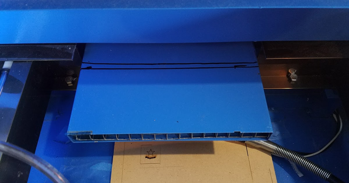

Decided I didn't want to take a chance removing the gantry.
Decided I didn’t want to take a chance removing the gantry.

FYI I cut the flue back without removing the gantry.
don’t get intimidated by removing the gantry. After the first few calibrations you’ll end up a pro. Gantry comes out and back in under 15min now when it was taking me like 2 hours the first time. Really is only 4 bolts which on mine self-aligned and weren’t oval.

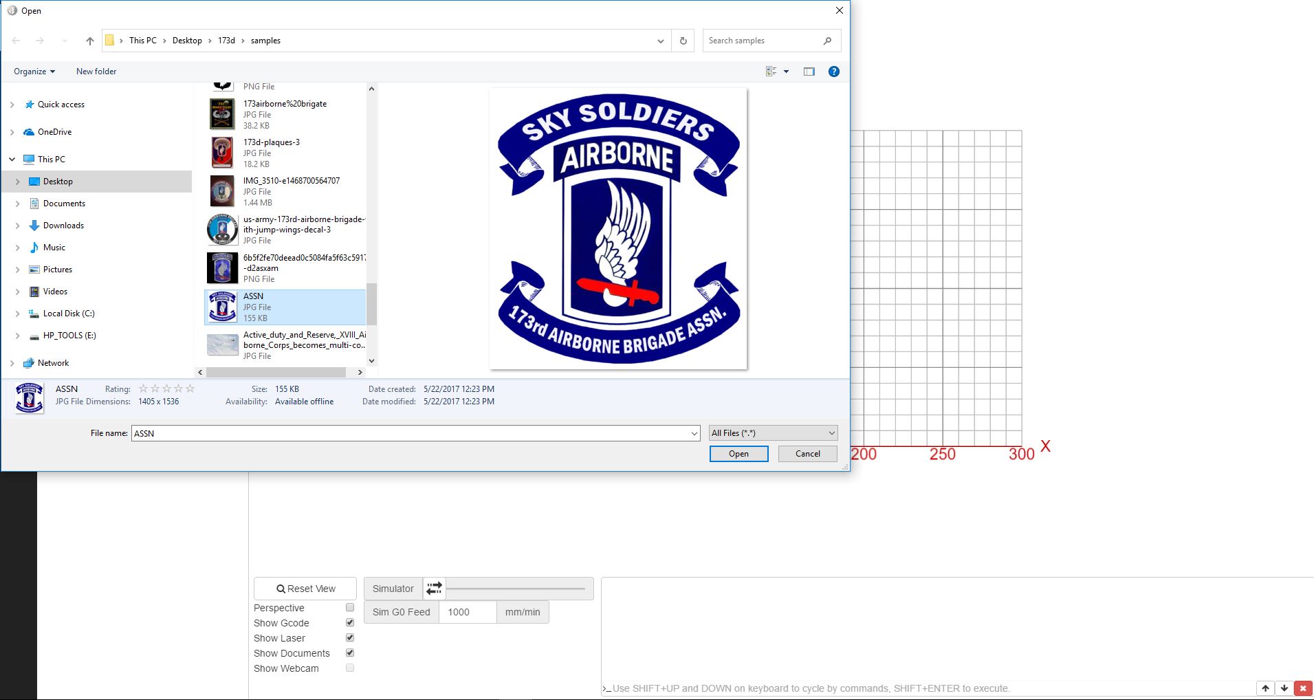

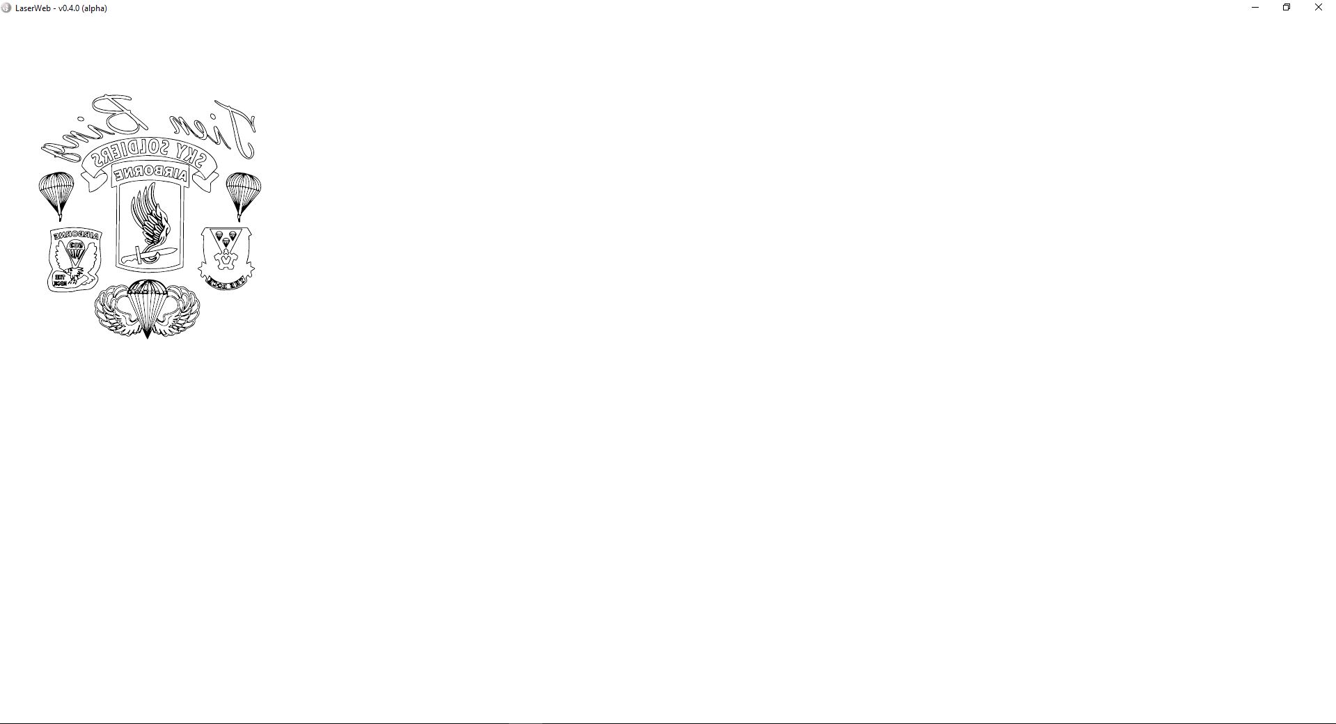

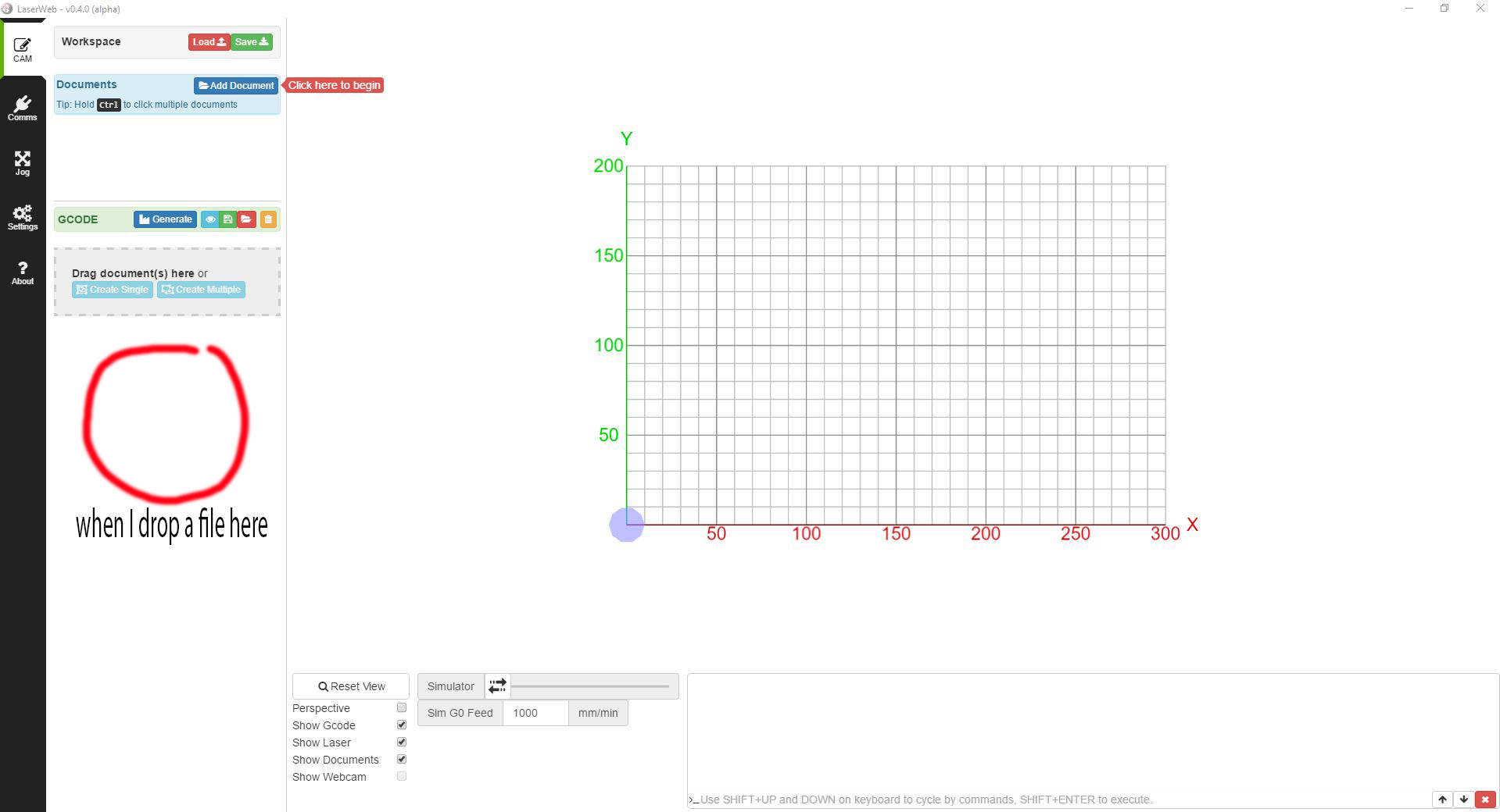

here are some screen shots
by the add documents higher up click open and open the file there. you drop the items in the files(actual paths) in the lower area
@bbowley2 droping the files in the wrong place

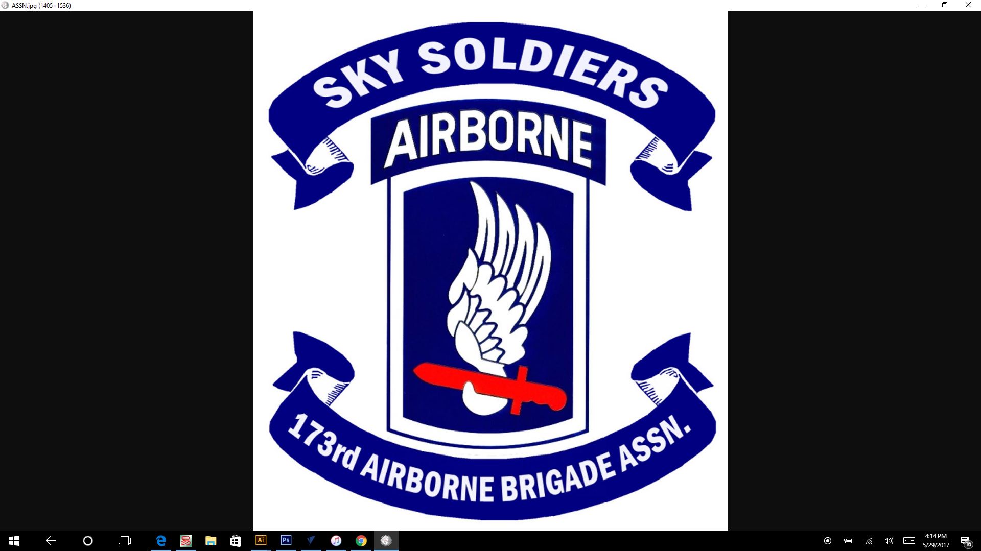

OK I dragged an image to the place just above the red circle. I have an image on a big black field with no tools visible. What’s the magic word to show the tool bar?
@bbowley2 you lost me there. Post image
Image is from an SVG. White BG. This is the entire screen.
That means you are not dropping the file in the correct place. Try use the other option that is to just select the vector you want to create an operation for and click where it says " create single operation "
next to documents theres this little red flag that says" click here to begin". I’d try that one!
Yeah, what seems to be the issue is that you are dragging the file from in windows onto that “drop document(s) here” bit right? & it’s doing nothing?
If I’m understanding correct, it’s what @Domm434 points out. You need to start by clicking the “Add Document” button at the top, which will bring up a file open dialog box where you can select the file. Then it will load all the elements of the file into the bar on the left in a tree view. You can then select those elements & drag to the “drop document(s) here” part.
Then further down you will find the Operations panel appears below that “drop document(s) here” allowing you to specify what you want to do (e.g. Laser Cut, then set the specific settings).
