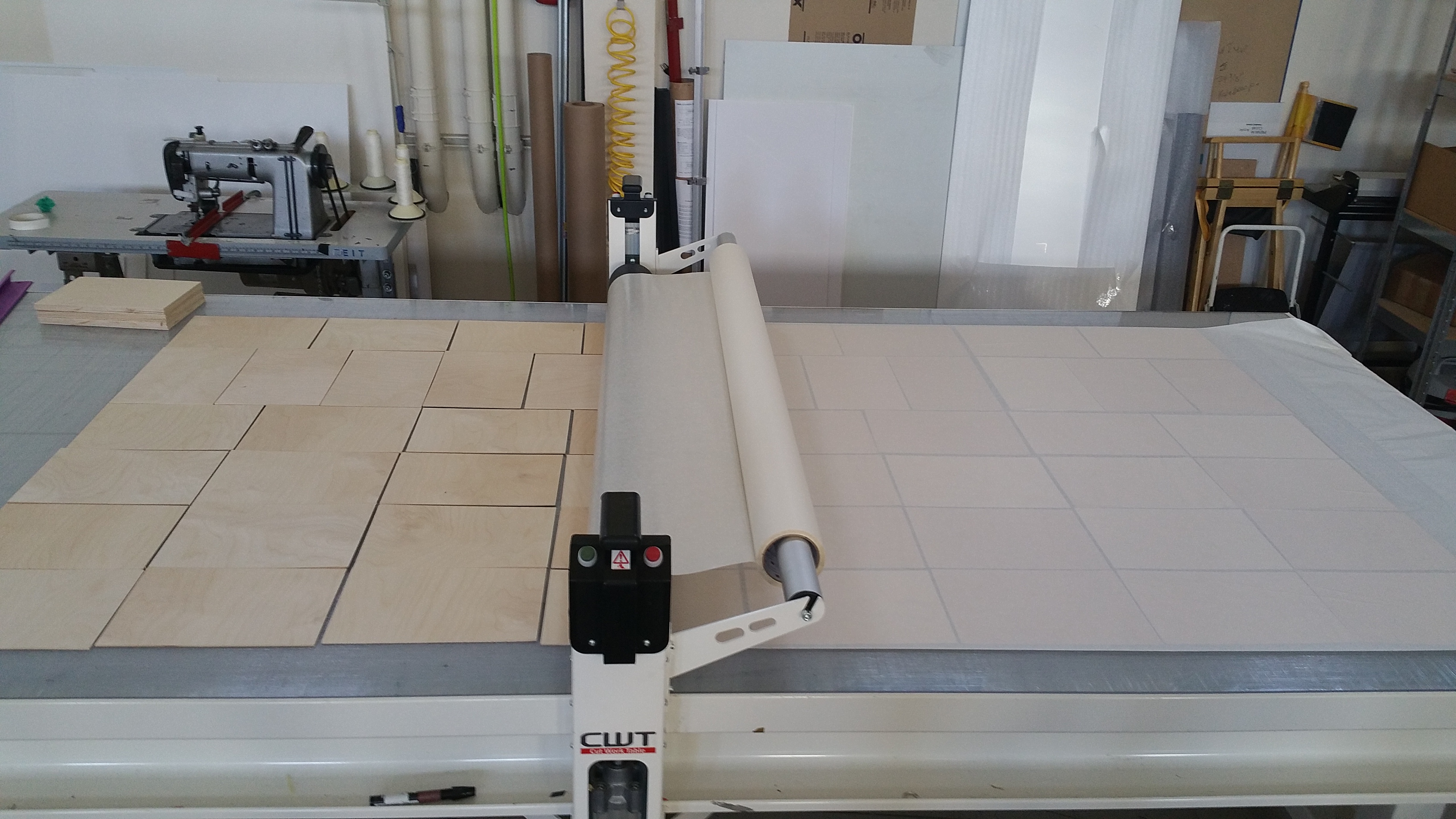

Thanks for sharing your process @Ashley_M_Kirchner_No . I’m curious what it is that you are using for masking the entire sheet of ply?
http://www.rtape.com/product-lines/conform-series-with-rla
I get wide rolls so I can do this:
Thanks for that. I’ve been looking around local hardware stores for something to mask with that is wider than 2" with no luck. Maybe something like that is a better option.
Note on that page that they have different strengths. I use the medium and low tack versions. And you’d have to ask RTape for a local distributor … I get mine through the print shop I used to work at.
@Ashley_M_Kirchner_No Thanks again. I’ll see if they have a local distributor here.
