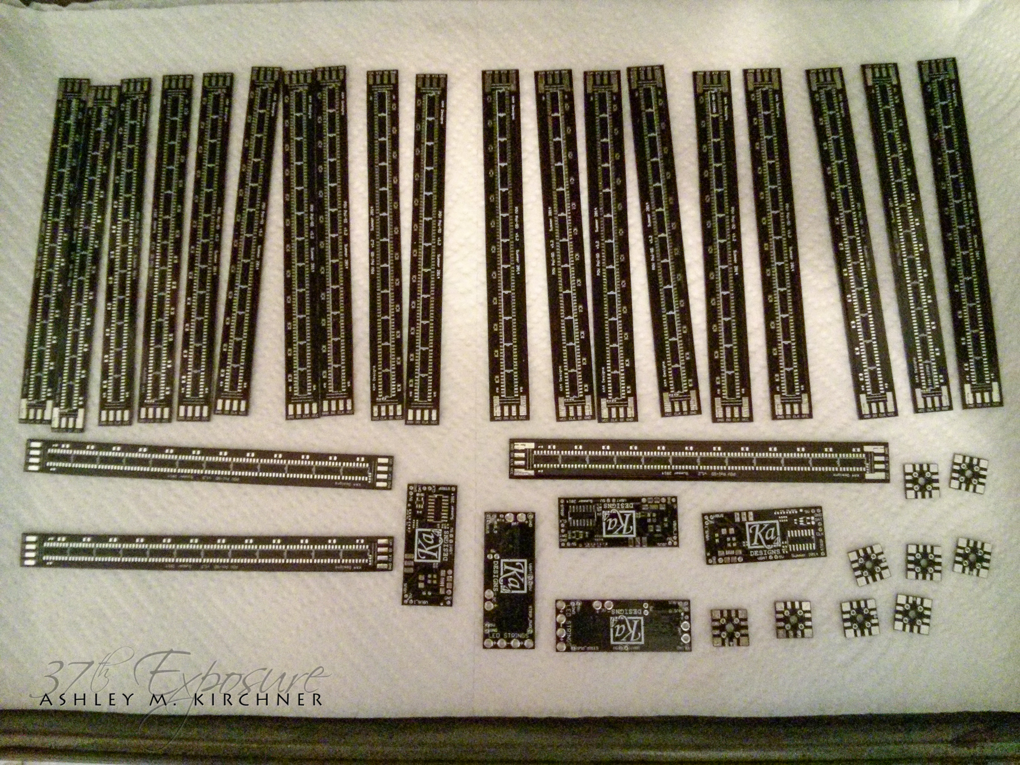

Decided to cut a few panels. Forgot how annoying fiberglass dust is … within minutes I had to stop after realizing I was sitting inside a dust cloud (of fiberglass) - not very smart. Had to get a dust collector going (read: vacuum with the hose extension directly under the Dremel blade.) What you see here is the pieces cut, washed, and fresh out of the oven, dry and squeaky clean. Now for the careful handling so I don’t get finger oil back on the pads prior to paste coating.
