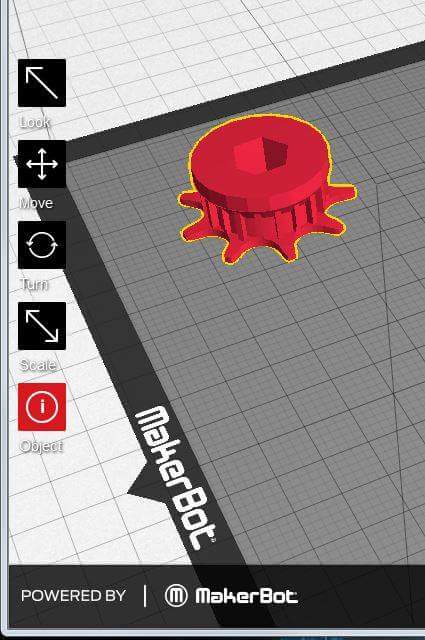

Decided to make a new post about a new bed leveling mechanism that was posted the other day on facebook and thingiverse. http://www.thingiverse.com/thing:1906231 it was originally intended to use a belt similar to a one used by a stepping motors. As that is a hard item to find in my area and I am too impatient to order one I have edited the gear drive to use a bicycle chain. Will post pictures later tomorrow of how it turned out. :slight_smile:

So I got this to work with a ball chain, will upload a video later to YouTube and then share here, for now a picture. :slight_smile: It seems to work really good, will adjust final tension when it is bolted into the machine. Took a couple days of thinking, but really did not want to use rubber or plastic belts as the laser can reach the front. Tried bike chain (too heavy) and just wondered around the hardware store till I seen this chain, haha. @Timo_Birnschein
